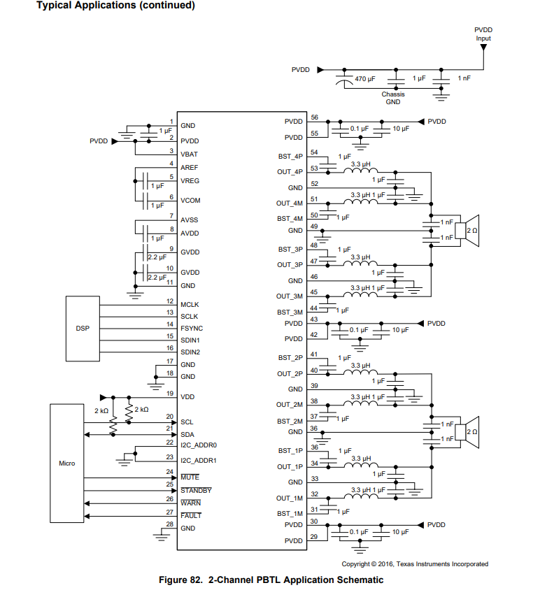

Hello Expert,
I think this is fundamental question but I'd like to confirm detailed PBTL operation.
We need to connect CH1P and CH1N through LC filter and connect CH2P and CH2 as well for archiving PBTL operation.
Does this mean CH1P and CH1N output same phase signal and become Negative output Side and CH2 side output positive signal as same as CH1 side?
