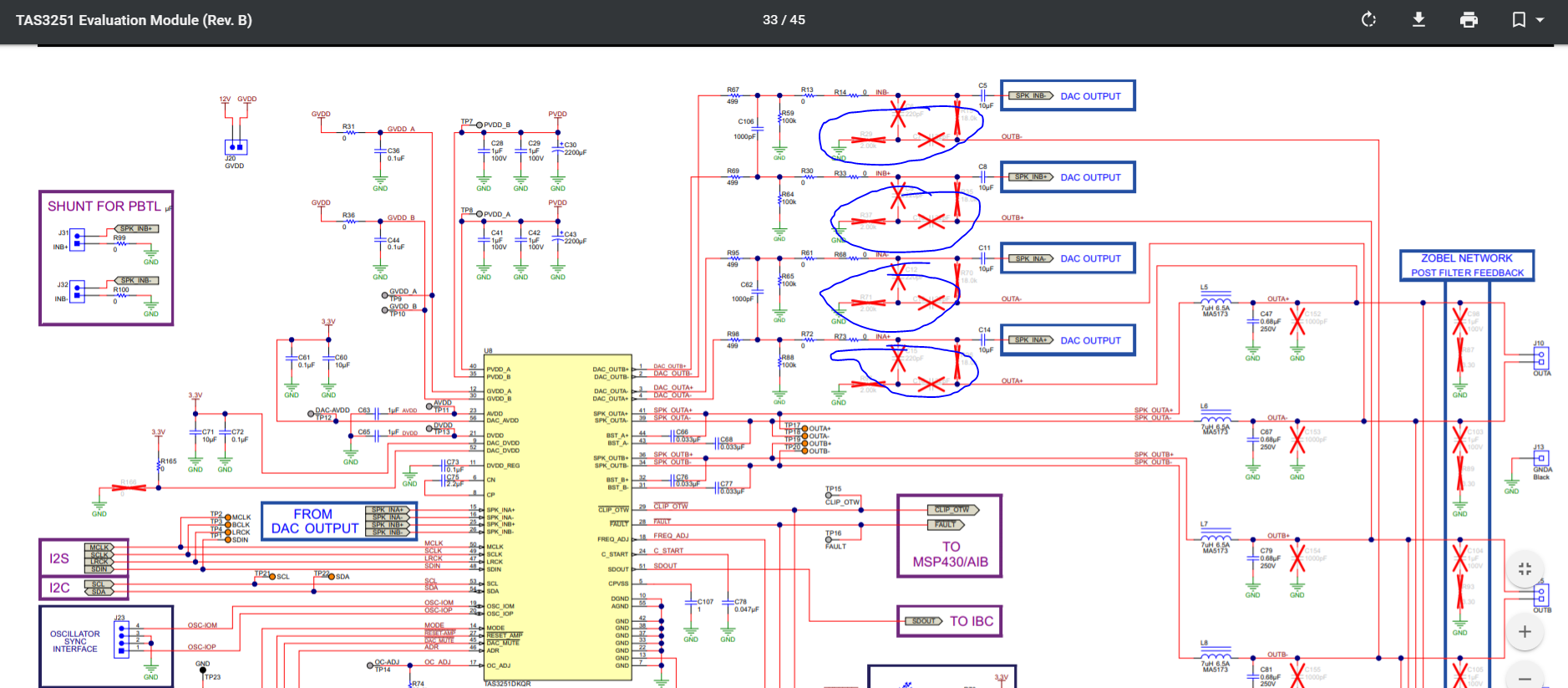

I don't understand the connection between OUTA+ and DAC_outA- shown on the TAS3251EVM SCH.
would you kindly help to explain why you put this optional connection on EVM?

Hi Shubiao,
This was for an optional post-filter feedback support.
