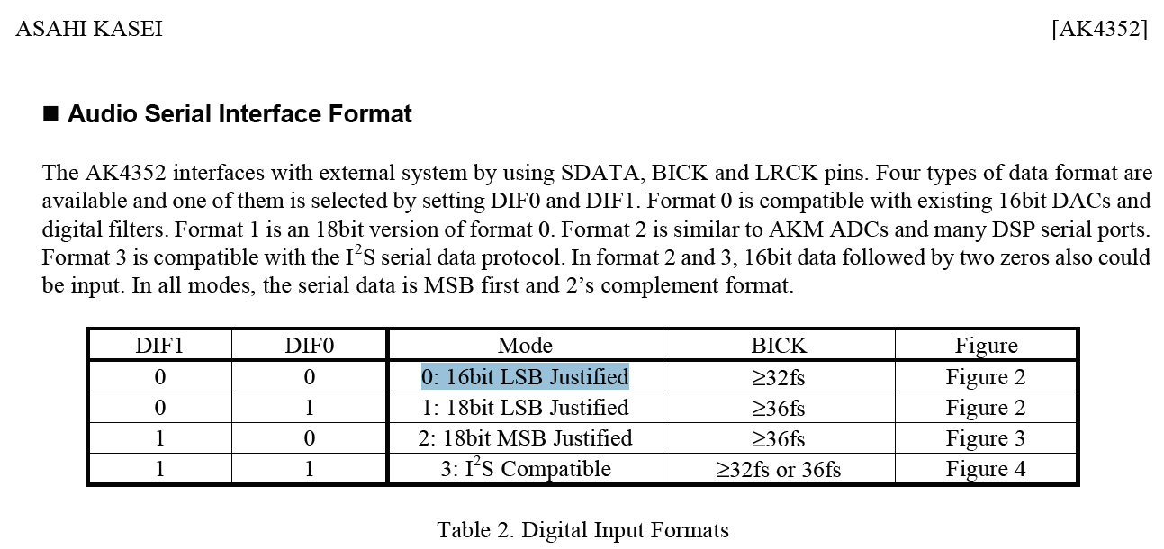

This time, there is Customer who has evaluated PCM1774 as an alternative to Asahi Kasei AK4352.
The AK4352 communicates with the microcomputer by using the attached 0: 16bit LSB Justified as an audio interface,
and the customer said that serial communication did not require register settings.
I found a description similar to AK's 16bit LSB Justified in the Description of the PCM1774 data sheet.
datasheet page1,DESCRIPTION
The PCM1774 supports right-justified, left-justified, I2S,
and DSP formats, providing easy interfacing to audio
DSP and decoder/encoder chips.
Is it possible for the user to operate without setting the register, like the AK4352?
Or do users always need to set registers?

  • Hello Paul,
    Thank you for your reply.
    The PCM1774 is in I2S mode by default, and you said you didn't need any special settings, but I couldn't read it that way, as noted below.
    ・datasheet page12,
    Power-On Reset and System Reset
    Internal circuits are cleared to default status,
    then all analog and digital outputs have no signal.
    Set Register data after turning all power supplies on.
    In addition, register 72 (PMXL, PMXR), register 73 (PBIS, PDAR,
    PDAL, PHPR, PHPL) and register 90 (PCOM) have a default value of 0.
    This is the power down state.
    For this reason, I thought it was necessary to set registers so that they could be used.
    Are these modules powered up by default in I2S mode?
    DDdoor
