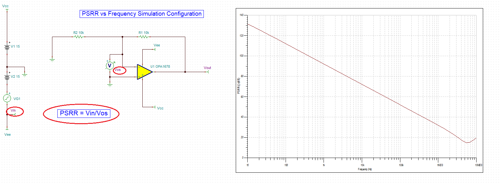

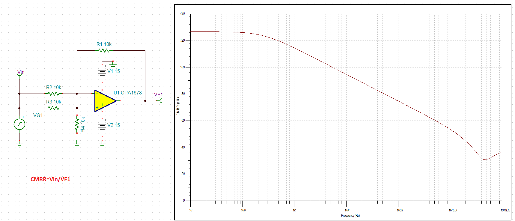

our customer using OPA1678 in their smart speaker, they they prefer to know the measure method of our PSRR and CMRR.
Could u help to give some suggestions?

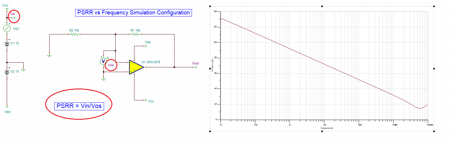

Below please see the setups and simulation results for OPA1678 CMRR and PSRR's.
I have attached below Tina-TI schematics for your convenience.
