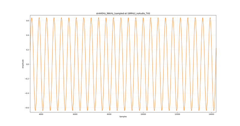

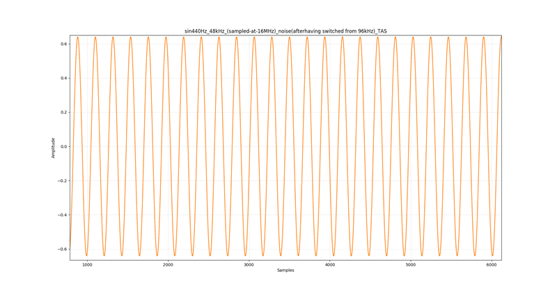

  • Hey Luis,
    Thanks for the prompt response.
    So, here I attach the plots of the data for all 3 scenarios described in the original post. The data were captured on the SDIN of the TAS with a Logic Analyser sampling at 16MHz.
    A sinusoidal wave of 440Hz frequency was chosen for this test. The following plots were generated by a python script taking as input the CSV files exported from sigrok.
    Scenario 1
    Scenario 2
    Scenario 3
    As you can see the data that arrives at the TAS is correct.

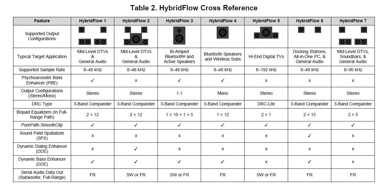

    The TAS5754m in the speaker uses the Hybridflow 4.
    However the data are also being transmitted to another device (with TAS5754m-Hybridflow 3) via a wireless communication protocol.
    This question actually made me look in the Hybridflow processor datasheet and I saw that HF3,HF4 support up to 48kHz. So that would explain why we are not getting audio in the scenario2 described in the original post.

  • Hello Costas,
    For 96k to work you need a Hybrid Flow configuration that supports that sample rate. If you use try to use 96k on a HybridFlow configuration that does not support it then it could cause issues which may be resulting on your end in these audio artifacts.
    Luis

  • Hello Costas,
    There isn't downsampling/sample rate conversion that can be configured for this device. You need to configure the TAS5754 for the Hybridflow configuration that supports that sampling frequency. It's also wouldn't be recommended to change the sampling frequency on the fly during audio playback as it could cause issues with the timing and processing of the data which may result in this abnormal noise you are seeing. If sampling frequencies are changed it would be recommended to mute the device during this transition.
    Luis

  • Hi Costas,
    It is long history and pls correct me if i have some misunderstanding of this:
    1. Scenario 2: White noise comes out in HF4 when playing 96K and overflow is founded;
    2. Scenario 3: SCLK and LRCLK loose sync when changing sampling rates;
    For scenario 2, i have to say HF4 cannot support 96KHz as below. As you know, Fs determines the maximum time internal mini-dsp can process audio signal.
    96K means the time will be down to half of 48KHz, which leads to insufficient time. Then i have to say any half-processed audio may come out and i cannot explain further due to the complex scenario.
    No SRC (sampling rate convert ) function is found here for this issue. May you configure I2S source from 96K to 48K?
    As to scenario 3, if possible, it is suggested to configure pre-stage I2S source to support only 48K.

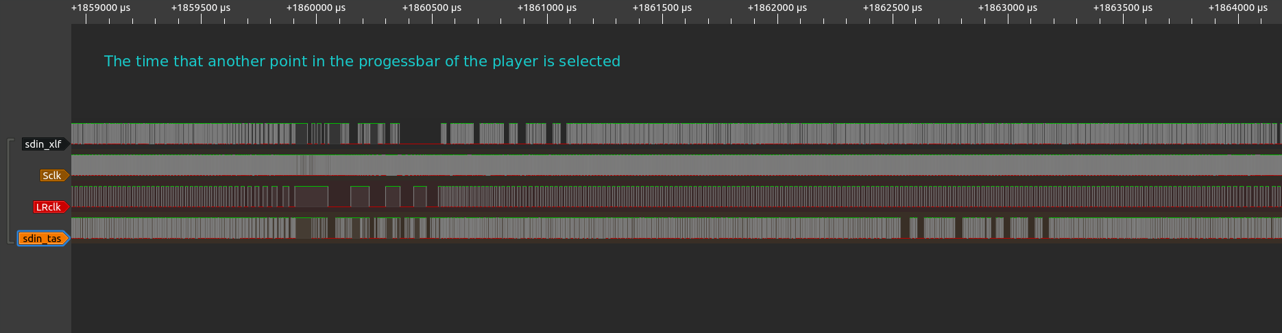

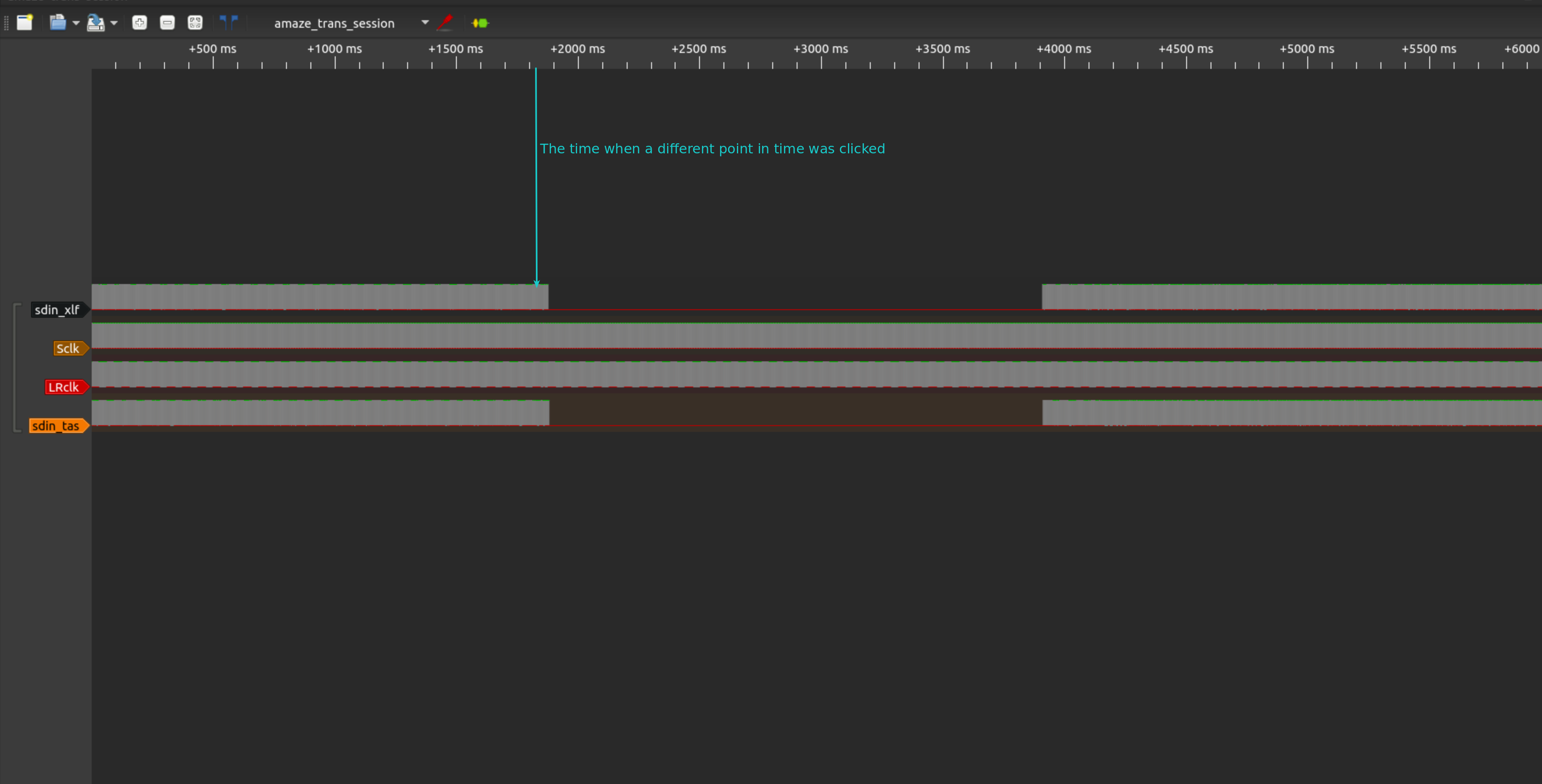

  • Hello Alix,
    Sorry for the delayed reply
    1. For scenario 2, white noise comes out as soon as I switch from 96 to 48kHz. When streaming in 96kHz I just dont have audio at the output of the TAS which makes sense since HF4 doesnt support it.My hunch is telling me that the noise comes because during the transition (from 96 -> 48) the clks are getting out of sync for a fraction of a msec and then they are stable again. However this fraction of time is enough to break the TAS and cause the channel Overflow in A-2 B-2.
    2. The same issue as scenario 2 is happening in scenario 3 when streaming surround sound. (ofc only 2 of the 6 channels arrive at the amp and the rest are transmitted wirelessly to other devices where the playback doesnt break). To be more specific I am quoting a part of my previous posts
    The audio in this case is being streamed only at 48kHz. When starting a stream the audio plays correctly and all the channels have the correct data. (verified with the Logic Analyzer). However I do get exactly the same type of noise that I have mentioned above when I either click forward or backwards in the progressbar of the media player (through which I am playing a video that is streaming 6 channels surround audio)
    image 1 : streaming surround sound at 48kHz. Zoomed in the exact time that the another point in time is clicked in the media player
    image 1 : streaming surround sound at 48kHz. Zoomed out of the prev picture. After the different point in time is selected there is a gap in the audio (reasonable until it buffers up the whole stream) and then the data continue to flow but only noise comes out of the TAS
    XLF is another module from which only the data pass through after coming out of the SPDIF input.

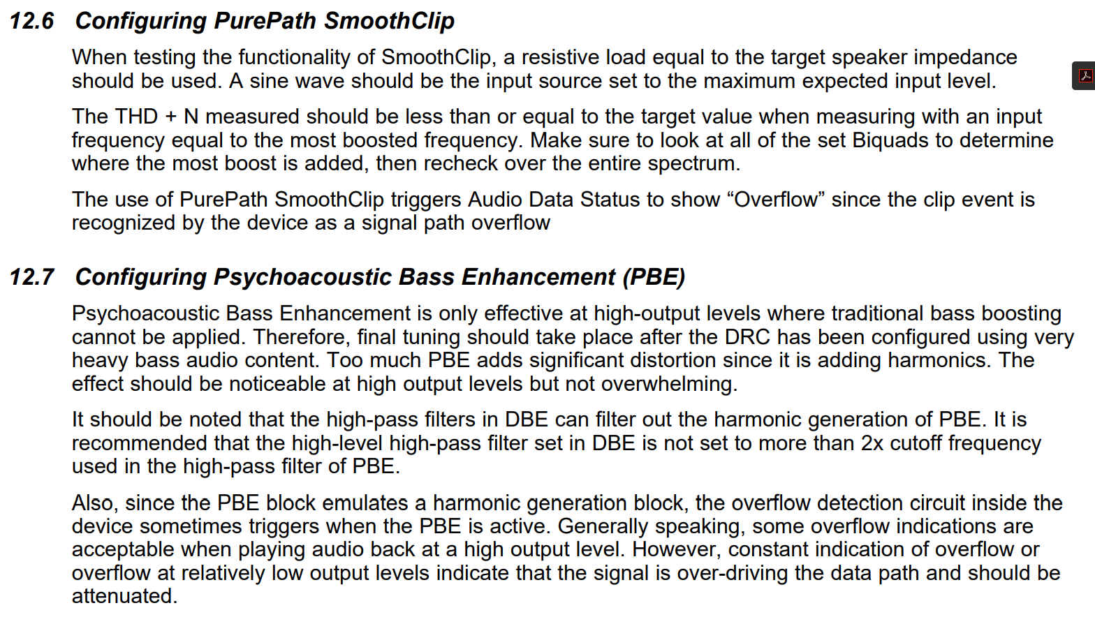

    Note 2: The noise is associate only with the channel A-2, B-2 overflow seen in the logs below (not the channel shifter overflow)

    For the channel shifter overflow I have read in the datasheet that is acceptable at times due to certain configuration on the mini-dsps.
    As Luis has suggested to prevent this loss of sync it would probably make sense to stop the clks until they are stable again. Unfortunately both LRCLK and SCLK are hardwired tfrom the SPDIF input to the TAS and we dont have control of them.
    Hope the issue is now clear to you. Please let me know if you need more clarification

  • Hello Costas,
    For the surround sound case, is your i2s source driving a tdm signal or an i2s signal, how are you sending 2 channels out of 6 in your system? Does the other 4 channels have their own i2s source.
    Also in regards to the audio source are you seeing this at multiple different audio levels? If the audio artifact is clipping and that is what is causing the overflow it wouldn't show up at lower audio levels but the main issue seems to be the data due to changing clocks so the Smoothclip wouldn't really be applicable in this situation.
    For your i2s source can you clarify what is doing as you are scrolling through the audio? I am seeing some strange behavior with LRCLK in your first image.
    Luis
  • Hi Luis,
    1. The signal path is the following. The surround sound is sent over TOSLINK/SPDIF cable from the source which is connected to our system. From there the TOSLINK data go to the PCB9211PT (TI module) and the output is the i2s_PCM_DATA , i2s_SCLK, and i2s_LRCLK. The PCM_DATA together with the clks enter on another module where the 6 channels are decoded (3 i2s_data_lines). The CLKS for alla 3 i2s_data_lines are the ones from the output of the PCM911PT module.
    Now ONLY one (1) of the i2s_data_lines is linked to the TAS5754M together with the clks.
    In addition, ALL 3  i2s_data_lines are driven to a 3rd party module on the system that transmits them wirelessly (over Kleernet) to another similar system. The wirelessly transmitted data channesl seem to cause no issue to the TAS of the other devices.
    2. As I have seen by thorough testing is that the overflow related to the Smoothclip is different than the one that is causing the issue. See my previous post.  Discrimination between shifter overflow and channel A-B overflow
    3. By i2s source do you mean the PC via which I am playing the AC3 test file? Well, as I said, I am scrolling through the audio in the media player and then the i2s clks go a bit "crazy" /lose sync and then they are stable again.
    Costas
  • Hello Costas,
    For the previously provided waveforms was that the output coming from the PCM9211 or from your SPDIF source, could you provide waveforms of both.
    Is this i2s clock instability apparent for different audio files that you play and across different media players? It definitely seems like abnormal behavior. Could you tell what the media player you were using and provide the audio file in your initial test.
    best regards.
    Luis
  • Hey Luis,
    I will try to provide you with waveforms later this week since due to the new lockdown it might be difficult to reach the office.
    I have been experiencing the clock instabilities with several ac3 test files and various media players (VLC, default win10 media player).
    My most common tests were conducted wtih the default win10 media player and playing one of the files of the dobly digital theater database ( Amaze Dolby AC3 5.1 640 kbps ).
    Costas
  • Hello Costas,
    I will await for you to provide the waveforms. Typically when scrolling through audio you shouldn't see disruptions in the BCLK, LRCLK only changes in the data it might have something to do with the configuration of your audio interface as the TAS5754M cannot operate normally if there is such abnormal I2S clock behavior.
    Luis
