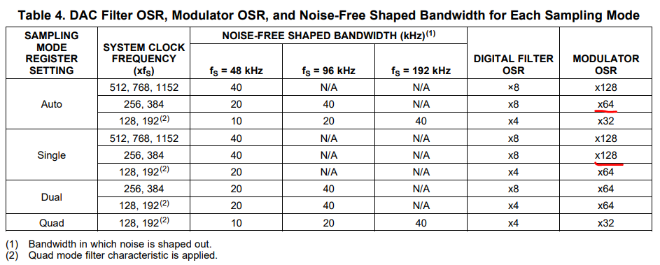

Q. Customer will use LRCK=44.1kHz, SCKI=11.2896MHz(256fs). In that case, the modulator OSR is different between AUTO and Single mode. In the Auto mode, the OSR is x64, but in the Single mode the OSR is x128.
If the Auto mode(x64), it correspond to DSM_Dual(x64) in Fig.19
If the Single mode(x128), it correspond to DSM_Single(x128) in Fig.19. Is my understanding correct?

    3. Your understanding is correct.
