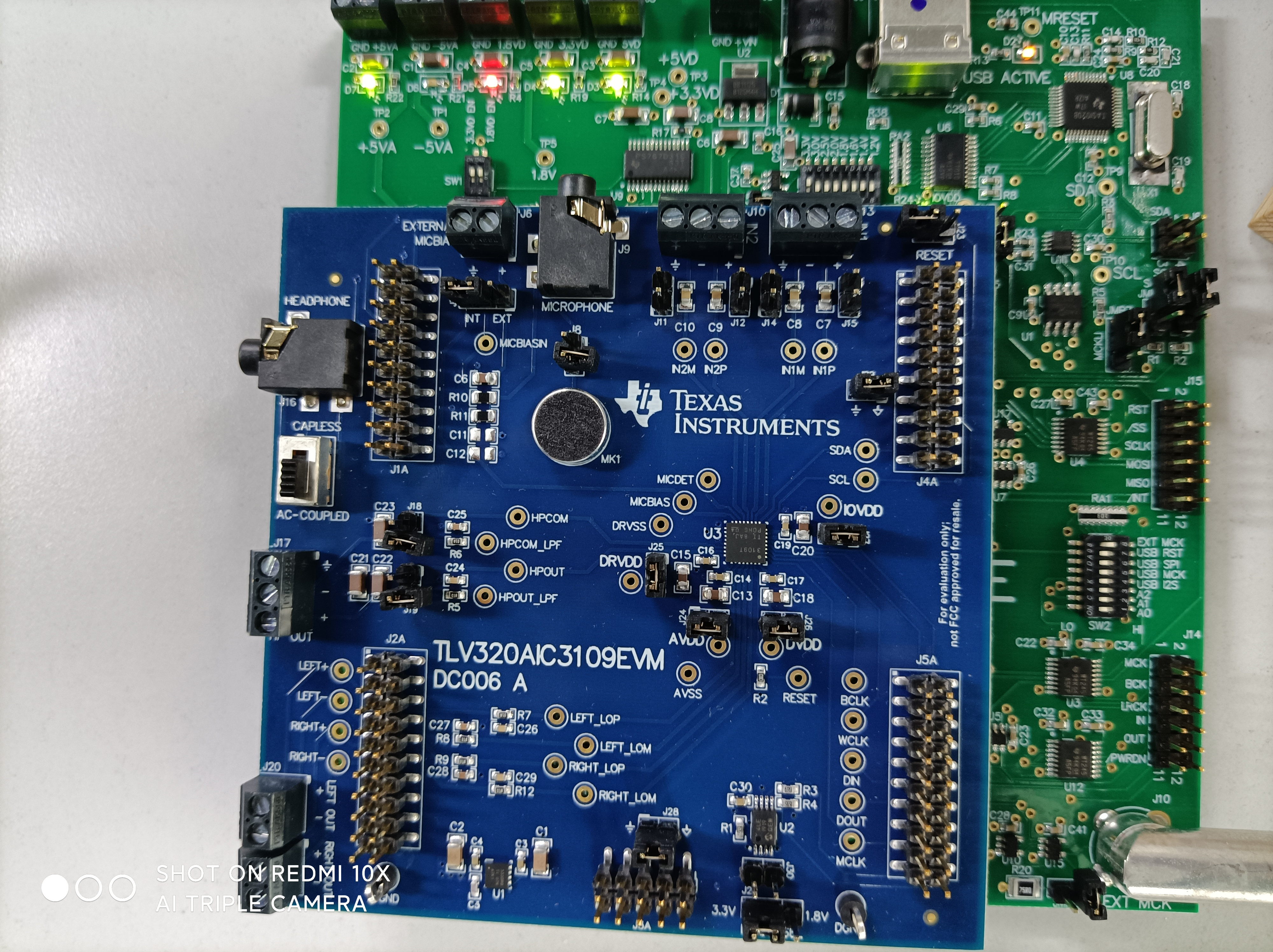

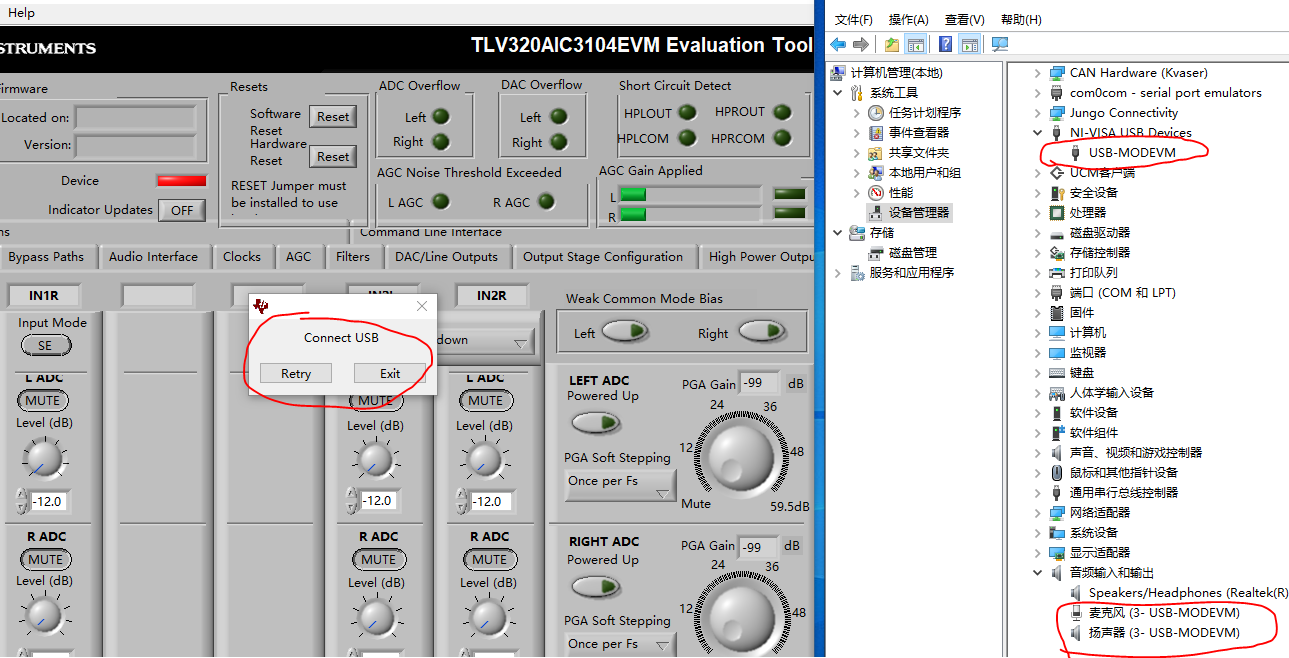

I followed the document "TLV320AIC3109EVM-K User's Guide.pdf" to operate, and found that the software cannot run normally.

Looking at the images you provided, I can see that the GUI drivers look to be installed correctly and the settings on the EVM are correct. I have seen in the past that installing the latest version of the NI-VISA drivers help with this. Can you please make sure the latest version of these drivers are installed and re-run the GUI?
