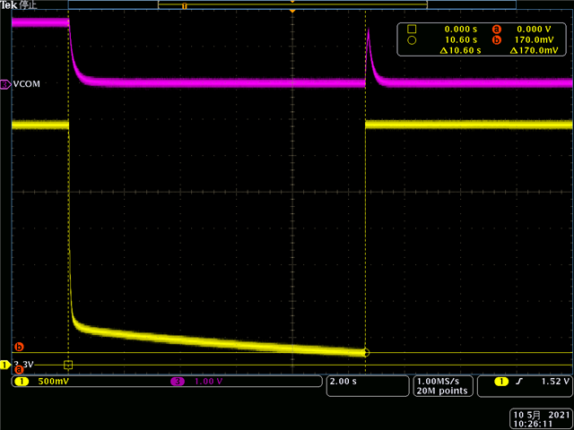

  • Hi-Paul-san
    It was found that this phenomenon occurs 100% when Power is turned on with a voltage of about 170 mV remaining in VCC1 and VCC2.
    There is no description in the spec sheet.
    Sends VCOM and VCC waveforms.
    Do you think what is happening inside the PCM1773?
    Thanks.
    Kurosaki
  • It is possible that the device is being kept in a brown-out state because the device is not fully powered off.  This would be some kind of unknown startup/POR case.  Is it possible to avoid this condition in your application?

  • Hi Kurosaki-san,
    This device would only feature ESD diodes from VCC to GND that would start to conduct at about 300mV above VCC. Similar diodes would be present on all the pins.  We have limited design input on this device, so I cannot provide specifics.
    I expect that what is happening is that the digital block of the device is not fully resetting due to the slow supply ramp down (or limited supply value), and that is very hard to confirm.  Could some kind additional current path be added to help discharge this line? For example, could a 1k-5kΩ from VCC to GND be added?
    Paul
