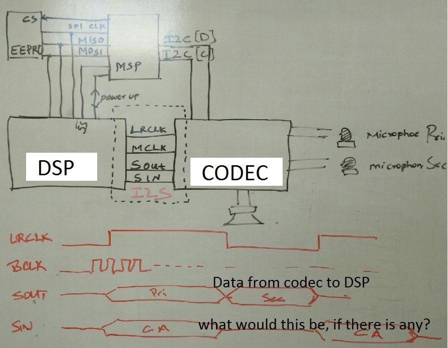

Hi All,Please forgive for my naive question here. I2S protocal has 4 lines, LRCLK, MCLK, SOUT and SIN lines. OF these LRCLK and MCLK are clock lines.
Assuming that I have interfaced an Audio codec to a DSP chip via i2S line. If I have transmitted Digital data from Audio Codec on SOUT line to DSP chip, what do I receive on Sin line.

Considering: Audio codec as Master and DSP chip as slave.

Hi Sri,
SDIN signal should be the digital audio data from the DSP. The codec receives that data and is able to process it and use it on any analog output. The attached document explains the I2S protocol. These application notes will provide you insight on Audio serial interface configurations with our codecs.

Hi Sri,
Yes, the DSP processing will add a latency to the audio data you are sending and receiving back.
