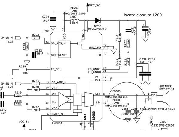

Hi.
Please help me ASAP.
I use Speaker is 2W/8Ohm and the schematic is attached below.
Some LM48511 is broken by unknown reason.
Broken LM45811's VDD and GND is shorted, I think HSFET is damaged.
Why this problem is occurred? Please let me know ASAP.
What point is I can debug?
In normal case, V1 and PV1 is 8~8.5V. not 7.8V (according to Table 3. Recommended Regulator Input and Output Voltages in datasheet).
Why this boost output is high?
