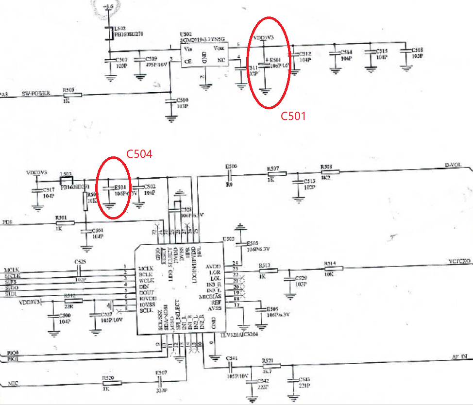

  • Dear Diego
         My issue is:
        When C501=10uF,C504=10uF, afrer 7.5V power on,the TLV320AIC3204 work normally, the current of main board is 0.1A;
        When C501=2.2uF,C504=0, afrer 7.5V power on,the TLV320AIC3204 can't work,and the device is very hot, check the current of main board, is up to 0.5A,but the normal current is 0.1A.
        please help me check the schematic,Why the TLV320AIC3204 can't work in only 2.2uF

    Thanks for the additional information. This is not a normal behavior for this device, but it is possible that the voltage on the HPVDD pin  is being affected somehow by the lack of the 10µF bulk cap on the pin. We recommend to keep the 10µF cap close to HPVDD pin in parallel with 0.1µF cap, is there any reason for you to not use it?.

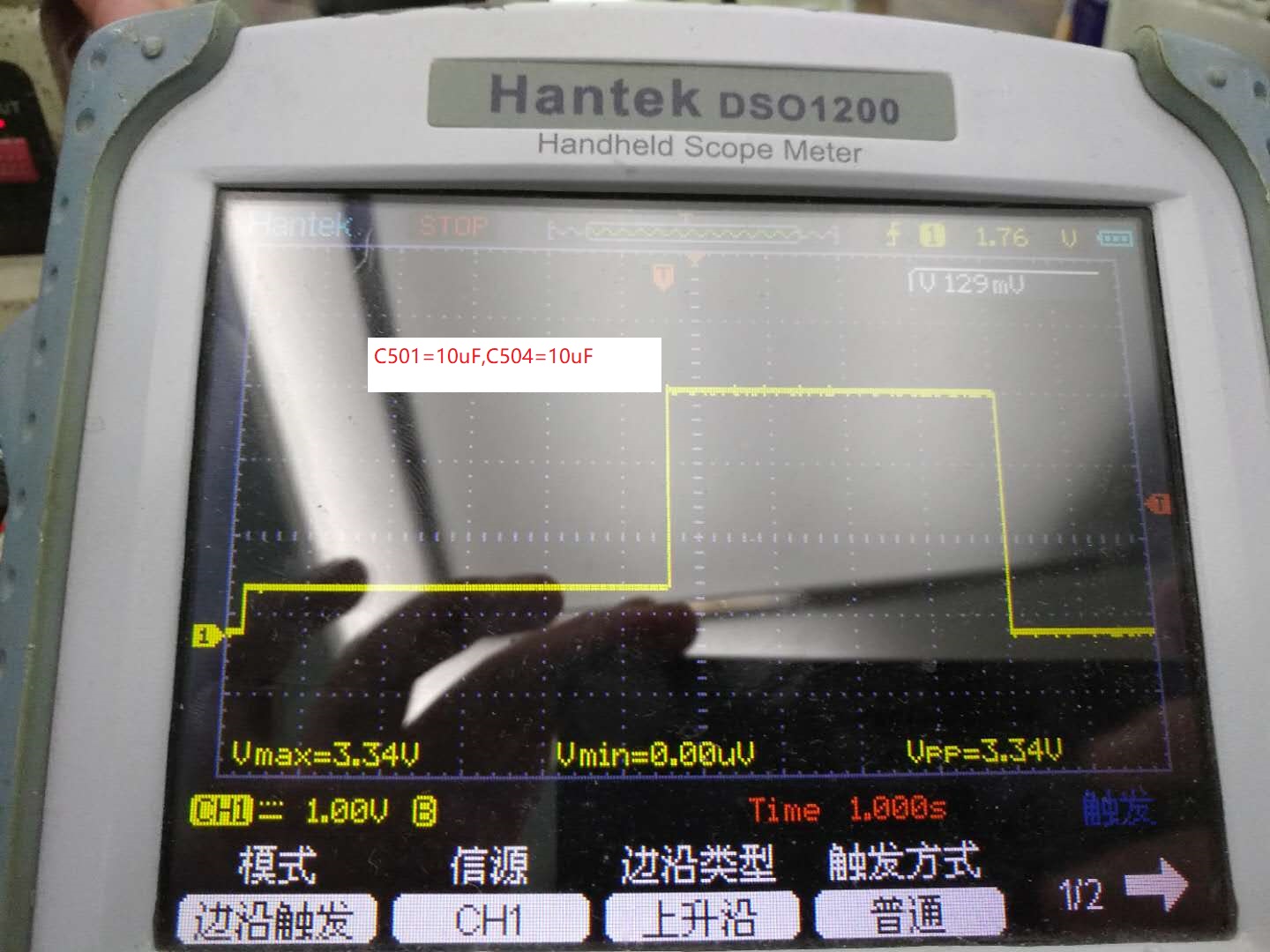

    Do you have any capture of HPVDD pin voltage under both cases (with and without 10µF cap)?.

  • Dear Diego
           1. In mass production,  I use C501=10uF,C504=10uF,but there is also similar problem, the probability is very low more. I think C504=10uF is too small ? The EVM is set 20uF. Do I increase to 20uF, make sure it doesn't happen ?
           2. I test the waveform of HPVDD pin voltage, is good,like this
           3. The first voltage is 7.5V, through DC-DC bucking 3.6V, then through LDO bucking 3.3V, supply for TLV320AIC3204.

    Thanks for the feedback. The behavior you are observing is not common for this device and should not be expected. The decoupling cap, either 10µF or 20µF, should not cause issues on the device. The value selection for it depends more on the power supply quality, in the EVM we put a 20µF cap to make sure the EVM works well even with poorly designed sources.
    After looking the scope captures, I noticed there is step on HPVDD, which may be result of the 3.3V LDO being activated before 3.6V input supply is  stable. I am not sure if that could be a problem as it is not a recommended sequence.
    I noticed as well that RESET is connected to HPVDD pin, so maybe the part is trying to get out of RESET state before 3.3V supply is stable. We recommend to keep RESET in low state until all the supplies are valid. Can you please check that this condition is met in your system?.
