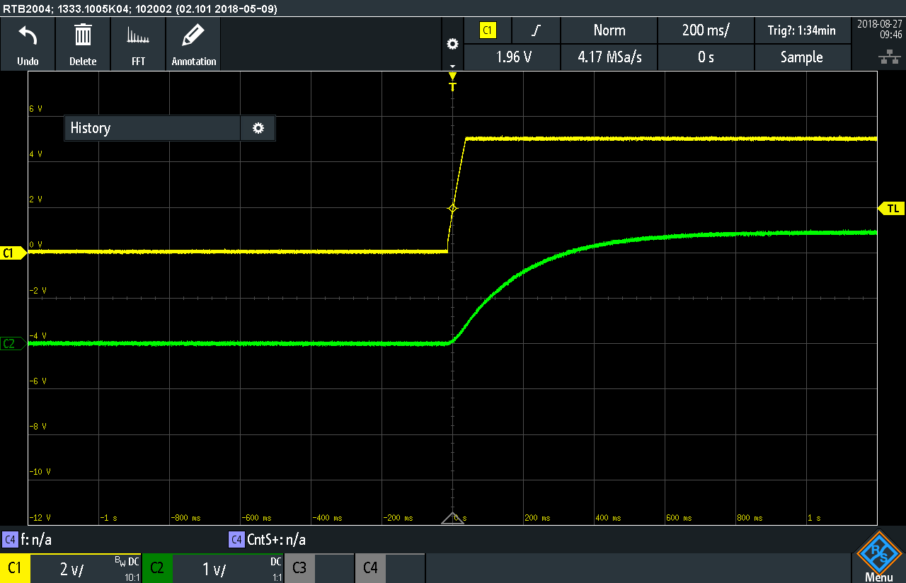

1. 10uF capacitor is recommended as the external on VCOM.
    Could you please clarify the time from VCOM start charging to complete the charge
    OR VCOM source current for 10uF capacitor?
2. It is not related to VCOM, 10uF tantalum or aluminum electrolytic capacitor are recommened
   on VCC. Could you please let me know reason why the ceramic is not suitable.
