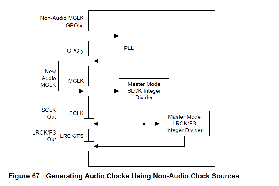

    As to configure TAS5782 in I2S master mode, there are 2 ways, one way is to provide MCLK and then get SCLK and LRCK as the reference you suggest; another way is to provide from GPIO0 and then get MCLK, SCLK and LRCK, we have problem in this way with the configuration above, would you please help as to review it, thanks a lot.
  • Hi Carsound,
    Difference between method 1 and method is whether Clock Master is from a Non-Audio Rate Master Clock or not. Now that you choose method 2: use GPIO as input to obtain MCLK=24.576MHz, SCLK=1.536MHz and LRCLK 48KHz, you solution maybe as bellow:
    This solution may be kind of difficult as we need to take input source into consideration. At least, pll is needed to be configured. I will generate the scripts for your reference. But would you share more information for me?
    1. Is it possible to use method 1? If yes, please refer to https://e2e.ti.com/support/audio/f/6/t/712412?tisearch=e2e-quicksearch&keymatch=TAS5782%20master
    2. Which GPIO is chosen to be input clk and output clk?
    3. What is the frequency of input clk (3.04MHz?)
    4. Is the input clk stable all the time?
    Alix Wan.
  • Hi Alix Wan,
    Thanks for your kindly reply, we want to try the 2nd method first. More information are as follows,
    1. A 12MHz clock input to GPIO 0
    2. GPIO 2 will output a clock of 12.288MHz and as a input to MCLK
    3. And then generate a 3.072MHz SCLK and a 48KHz LRCK from 12.288MHz MCLK
    4. The 12MHz clock input to GPIO 0 is providing by a oscillator, it will be stable all the time
    Please generate the corresponding scripts for us, thank you very much.
  • HI Carsound,
    GPIO2 cannot output 12.288MHz and can only output 24.576MHz due to internal clock requirements.
    Hence, based on your spec, I would recommend following scripts for you. Please try and debug.
    Any futher debug comments are welcome for further analysis.
    #Recommended scripts: see page 39 of DS for more details
    w 90 00 00
    w 90 02 10 #enter standby
    w 90 25 01 # just disable clock auto detection;
    #configure GPIO0 as clk input && GPIO2 as output
    w 90 08 20 #GPIO2 output GPIO0 as input
    w 90 52 10 #PLL output to GPIO2
    w 90 0D 30 #configure PLL ref clk=GPIO
    w 90 12 03 #GPIO0 is input
    #98.304MHz is divided by 4 and output 24.576MHz to GPIO2
    w 90 14 00 #p=1
    w 90 15 08 #J=8
    w 90 16 02 #MSB: D=02
    w 90 17 53 #LSB: D =53 hence:D=0253
    w 90 18 08 #R = 1
    #configre OSR and Fs
    w 90 1E 07
    w 90 22 03
    #configre SCLK and BCLK output
    w 90 20 07 #SCLK = Master clk/8 = 3.072MHz
    w 90 21 3f #LRCLK = SCLK/64 =48KHz
    w 90 09 11 #LRCLK and SCLK output enable
    w 90 0c 7f #reset clock
    w 90 28 00
    w 90 02 00
    Alix Wan.

  • Hi Alix Wan,
    Thanks for your help.
    we add PLL enable and modify the value of some PLL function factors, now it works well.
