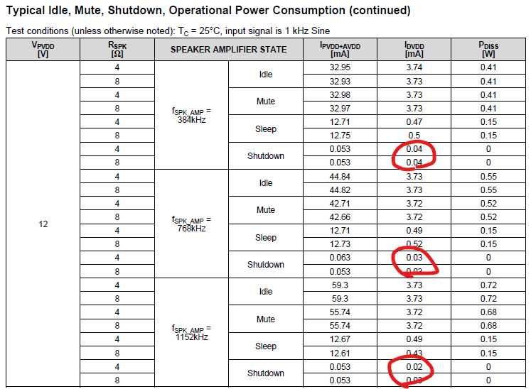

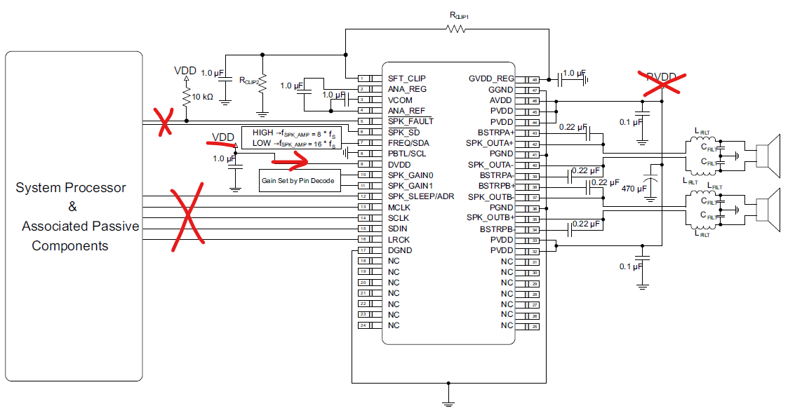

Hi, team,
My customer has one question about TAS5760M-Q1. There system requires for <100uA input quiescent current when system is in standby mode. Thus PVDD/AVDD of TAS5760M-Q1 is removed, but DVDD 3V3 rail is kept for MCU standby power.
For TAS5760M-Q1, what is the 3V3 DVDD pin input current when PVDD/AVDD is removed?
Thanks.
Johnny
