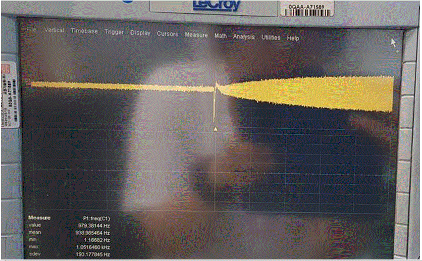

TLV320AIC3204: Can I resolve pop noise of line out?
Part Number: TLV320AIC3204
Hi TI team.
It is line output wave.
Input : I2S (0dB, 1k sine wave)
Issue : Pop noise, effect of fade in.
I tried this (ACG mode - disable, soft stepping - disable and DRC - disable) but it did not improve.
When the register value is fixed as below, the pop noise and the fade in effect disappear.
[Page 1, Register 9, D(3,2) = 1 ]
Question.
1. If the register value is fixed as shown above, Is there a problem?
2. Please tell me another way to solve the problem.
Downey Kim.
Thanks & Regards.
