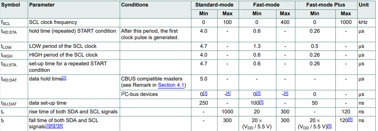

Regarding to Fall time of I2C Standard-mode on TAS5825M, my customer is asking a question.
According to datasheet, fall time of SCL/SDA are 20+0.1*CB (ns) to 1000(ns).

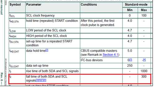

But according to I2C specification(UM10204), it is characterized only maximum 300(ns) at Standard-mode.
TAS5825M
・I2C specification
(Question)
On their application(TAS5825M), fall time of SCL/SDA are 4.4/4.2(ns) on Standard-mode.
Are there any problem with values as I2C specification?
Are these values matched on Standard-mode specification?
Tao 2199
  • Hi Tao,
    The UM10204 I2C tf fast mode min value is 20*(Vdd/5.5) as below.
    TAS5825 IC design specs the same min spec for both standard and fast mode to maintain stability. So it's suggested to follow datasheet spec requirement, and modify 4.4/4.2(ns) fall time of SCL/SDA to meet requirements.
    Matthew
