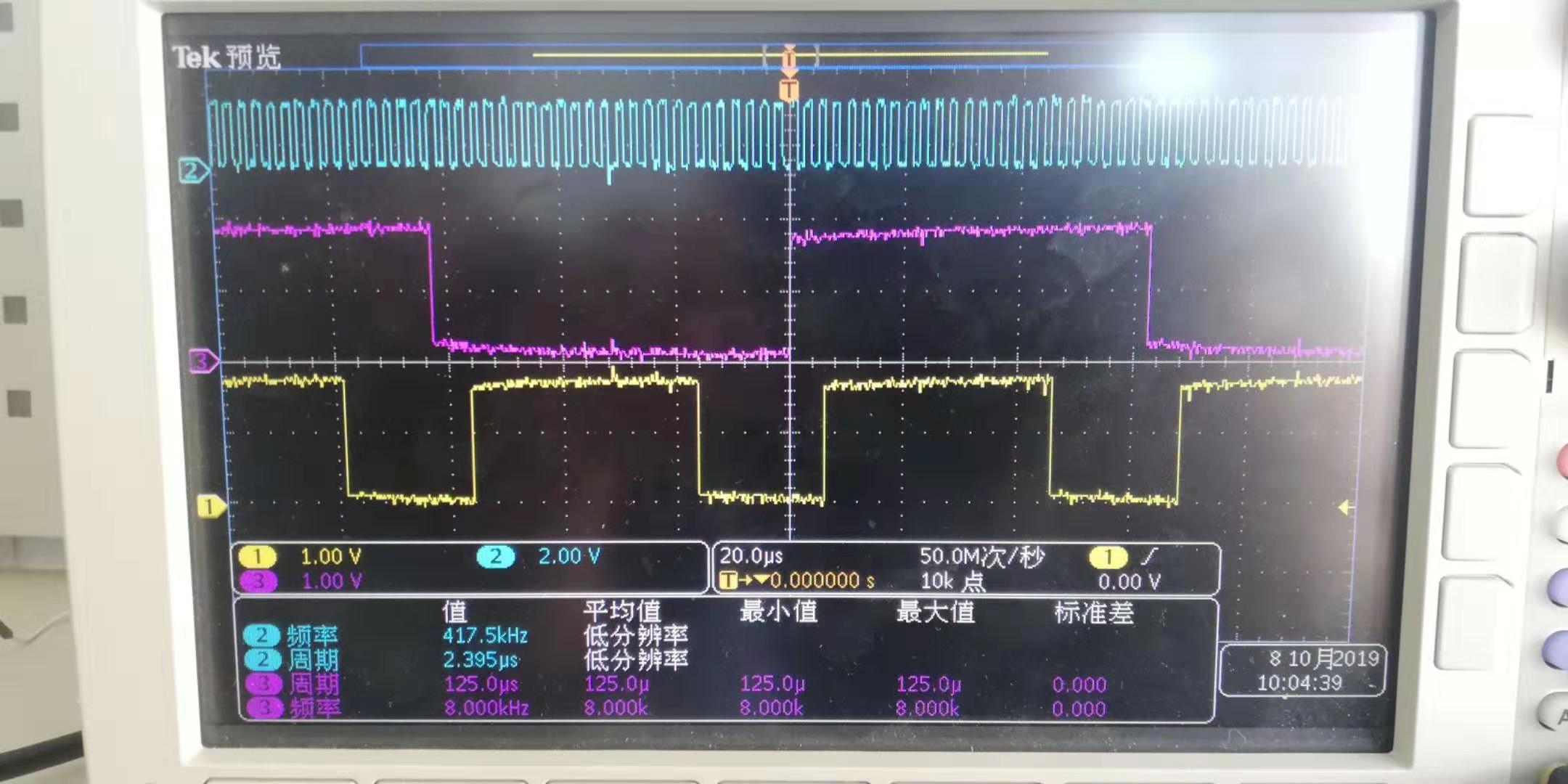

Customer is using TLV320AIC3106 as slave. When I2S is the master, it encounters a phenomenon: TLV320AIC3106 headphone jack does not plug in headphones, I2s will receive codec sent 0x3fff3fff, or 0x3fff0000, 0x00003fff. What might be the problem?
Amy Luo
  • Hello Amy,
    I am not quite understanding the issue.
    Correct me if I am wrong but are you saying that when no headphone jack is plugged in, the codec will send codes  0x3fff3fff, 0x3fff0000,or 0x00003fff? What is the intended operation of the codec? Can you share some scope shots of this issue a long with the CLK signals?
    Aaron
  • Hello Aaron,
    Thank you for your reply。you are right !  When not plugged into the headphone jack, the codec will send the code 0x3fff3fff, 0x3fff0000 or 0x00003fff.

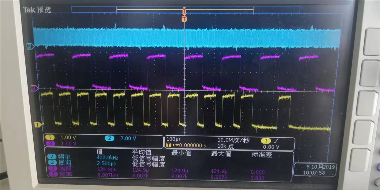

    This is the waveform when no headphones are plugged in.  channel 1  is dout, channel 2 is serial clock-sclk, and  channel  3  is frame clock-wclk.

  • Hello Qin,
    Thanks for the clarification and images. Can you provide a little more info?
    • What is the customer trying to achieve?
    • Can you provide register settings and schematic?

  • Hello Aaron,
    I want to achieve a loopback effect, that is, codec receives data through mic, and sends it to our FPGA board from dout.
    The FPGA board then sends the data to codec, from din to codec, and through the headphones.
    I will hear what I said in the headphones; but now the data I hear in the headphones has a very loud noise, covering up my own voice,
    when I don't plug in the headphones, I will receive 0x3fff, 0x3fff3fff, 0x3fff0000 These data, so I want to know is not because these data lead to noise.
    The attachments are schematic and register settings.

  • Hello Qin,
    I had some time to look through the schematic and the register configs. Here are some questions/suggestions:
    1) All unused inputs should be tied together and shorted to GND using a .47uF capacitor.
    2) Why are MIC3R and MIC3L connected together and being sent to both left and right ADC's?
    3) In the register configs, I noticed that Line1L and Line1R are routed to the both the left and right ADCs and not being used. Why is this? This could be providing some unwanted noise. Again, I recommend following my first comment.
    4) What is the FPGA doing with the DOUT data?
    As a sanity check, you are measuring DOUT and not DIN correct? Noise at DIN would imply the FPGA is providing the noise.
    Aaron

  • Hello Qin,
    Thanks for your reply. After reviewing the information you have provided a second time, I have some more questions/comments:
    1) Can you connect DOUT directly to DIN and see if this issue still occurs?
    2) I see that your BCLK is 400kHz in one capture and 417kHz in another. Your BCLK seems unstable.
    3) Looking at your PLL configuration, I am assuming you are supplying an MCLK of 24.576MHz. Is this correct? If so, the PLL constraints are being exceeded. I would change P to a 2 and J to an 8 to meet the constraints described int the data sheet.
