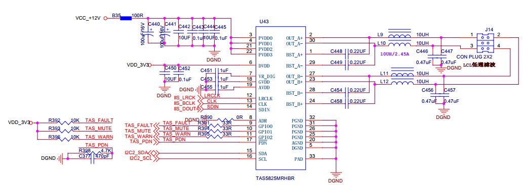

TAS5825 will enter sleep mode when it work sometime, we found CHAN_FAULT Register (Offset = 70h) is 0x08, DEVICE_CTRL2 is 0x03, STATE_RPT is 0x01, there is left channel DC fault, how to avoid this issue,thanks.

do you have detailed schematic and input signal/output signal plot? can you show us and we can help debug together.

When DC fault occurs, TAS5825 will enter into sleep mode and report the DC fault.
Notice that J14 can be configured as PBTL with A+/B+ and A-/B-, am I right?
Hence, please clarify when does this issue occur?
