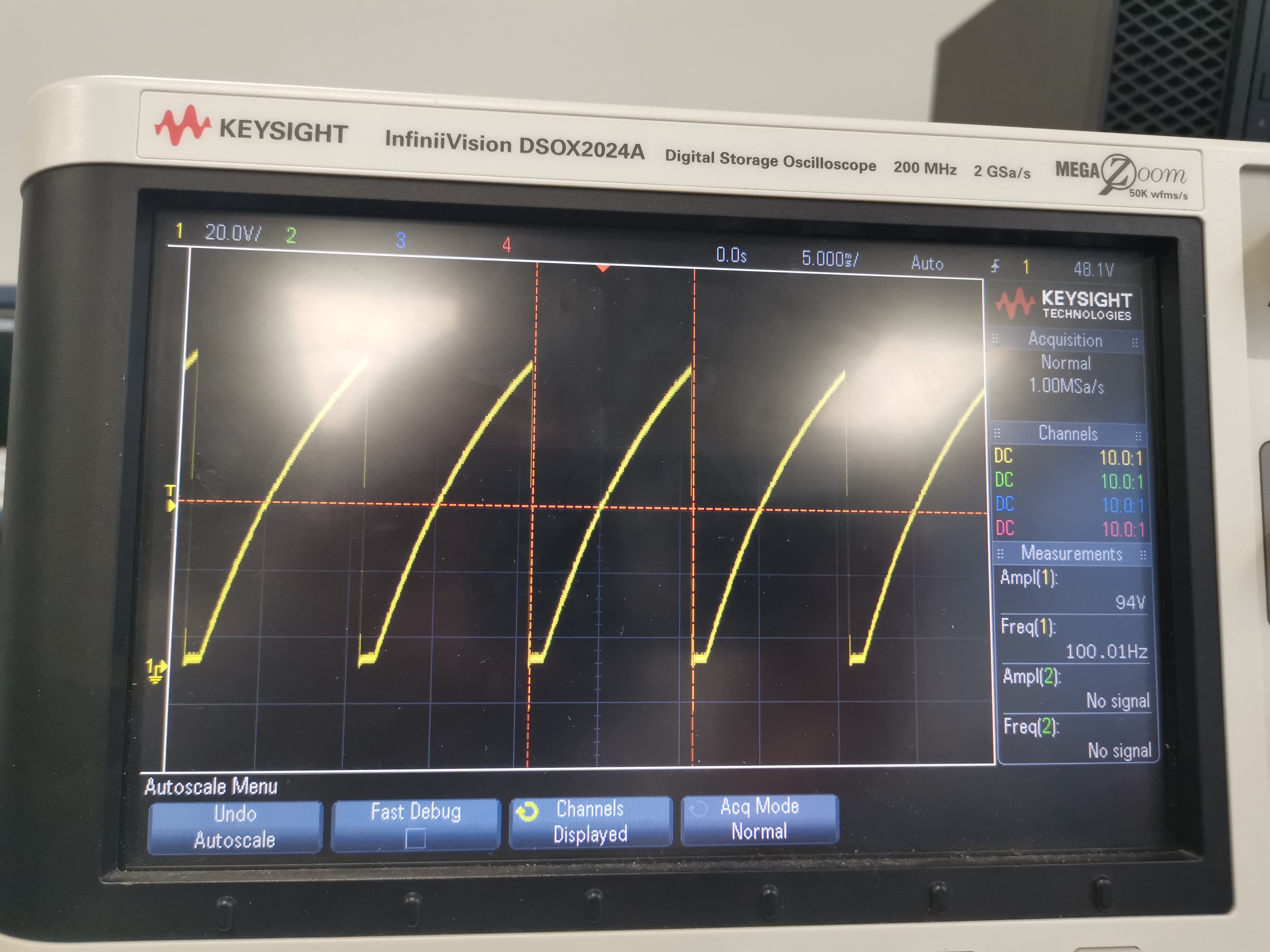

Following the instructions on the user manual, we removed relevant resistors and capacitors, and set the jumper positions according to the boost of interest. For all the boosts up to 105 V, we found out that the output amplitude was far below the expected value. In addition, there was something like saturation happening in the output.

    Could you provide more details about the jumpers positions, removed components, power supply level and registers configuration, please? If possible, could you also share the details of the waveforms? For example, a scope capture showing the input and output with the saturation issue. Is this possible for you? This would help us to have a better approach to this issue.

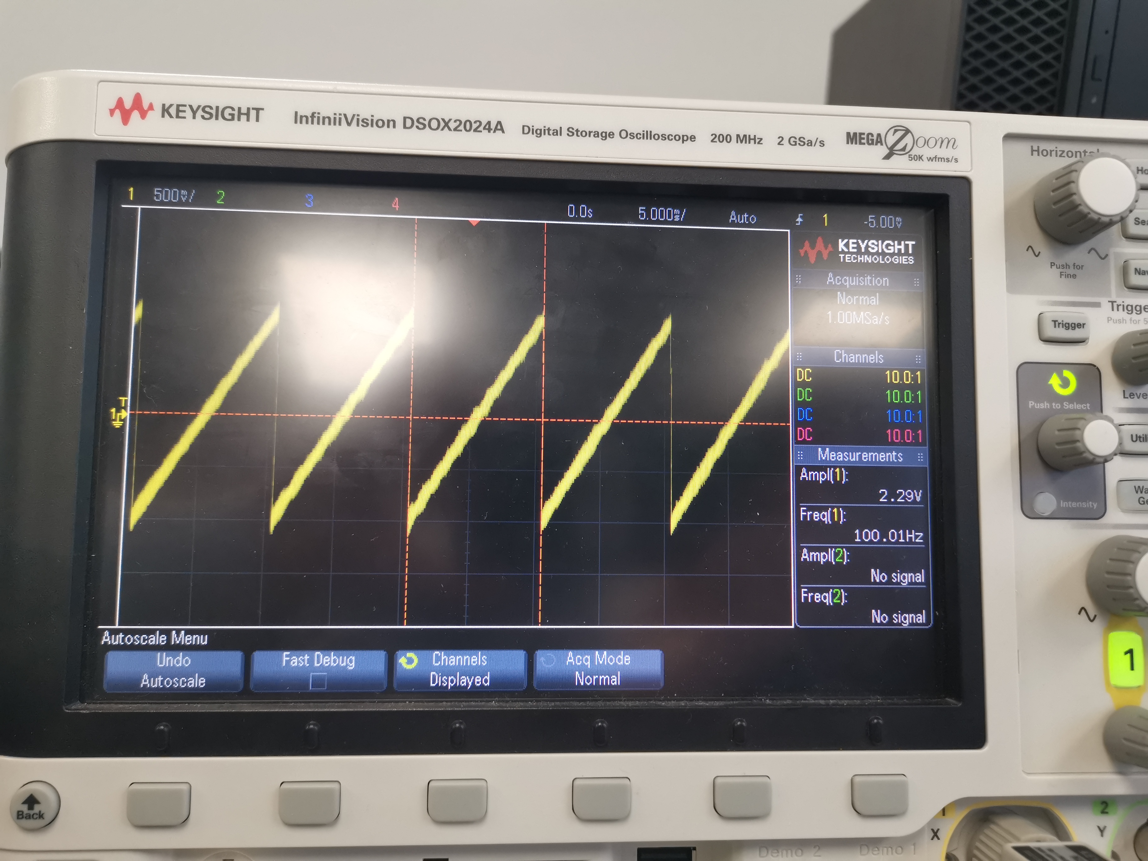

    Attached are pictures of the input we generate from a waveform generator, measured input at the analog input terminals, and the output measured at the output terminal.
    In this case, we set the boost to be 105V with jumper 5 and 6 open, jumper 2,3, and 4 closed. We did not change any register configuration so it should be the same as the default.

    Could you explain the pictures that you attached? I mean, could you provide details on what the input and output signals are? Could you describe the issue on your pictures? This would give us a better approach to the issue.
