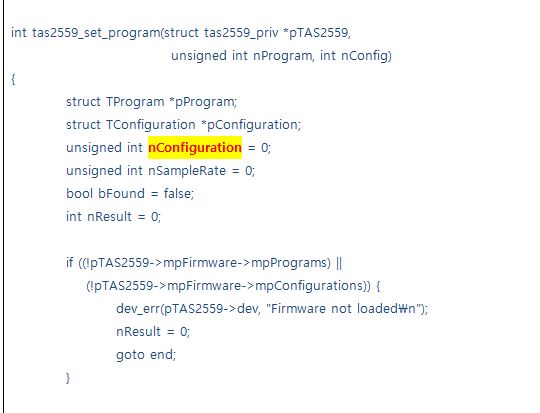

Hi
My customer is optimizing and debugging the tas2559's software.
They inquired about the reference code of TAS2559.
It seems to be the configuration value set in the firmware. Can you know the meaning of "nConfiguration"?
All source codes are attached.
Please Check it.
Thank you.
Best Regards
From Anthony
tas2559.txt

int tas2559_set_program(struct tas2559_priv *pTAS2559,
                                unsigned int nProgram, int nConfig)
           struct TProgram *pProgram;
           struct TConfiguration *pConfiguration;
           unsigned int nConfiguration = 0;
           unsigned int nSampleRate = 0;
           bool bFound = false;
           int nResult = 0;

  • Anthony,
    Here our comments regarding nConfiguration:
    The firmware binary can have ‘m’ programs and ‘n’ configurations. A program can have multiple configuration that only changes the tuning coefficients while not changing the underlying program. A program might need to change if for instance if we change from Tuning mode to ROM mode, the program would change, that in turn can have multiple configurations.
    -Ivan Salazar
    Applications Engineer - Low Power Audio & Actuators
  • Hi Ivan
    Thank you for your answer.
    Then, when we change the value of nConfiguration, what function of TAS2559 is changed?
    Also, my customer's inquiry asks if the value of the digital filter changes as the nConfiguration value changes.
    In conclusion, my customer wants to know how nConfiguration affects IC operation, and if necessary, wants to control such as changing to the desired setting.
    Please Check it.
    Thank you.
    Best Regards.
    From Anthony.
  • Anthony,
    As described in the previous reply:
    To answer your questions:
    1. what changes is tuning coefficients: EQ, DRC, etc
    2. if digital filter means EQ, then these are changes by nConfiguration
    3. nConfiguration can change only tuning settings
