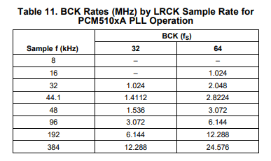

    Heavy distortion is usually caused by one of two things: 1. you clocks are not accurately synchronized or are not compliant with the requirements of the DAC, or, 2. The load on the output is too great.
    For the first issue, I recommend to you very the clock speeds of the LRCK and BCK.  SCK should be grounded if you are not using it.  The BCK must be a continuous clock, and 32*fs or 64*fs as shown on the table below.

  • Thank you for the prompt reply. I have grounded SCK and have measured the AudioB chip's LRclock at 48-49kHz. I measured the BCK at 198kHz, but i think its past the limitations of my 20$ diy oscilloscope kit (no sharp wave form at the smallest time division, 10us.) Instead, i refer to the manufacturer data and see that the published rate is not included in the table. The listed rate is 2.304 MHz- close, but not quite either 1.536 or 3.072 MHz, for a 48kHz sample rate. Is there anything that can be done?
    For reference from the AudioB chip manufacturer:
    "...I2S digital output and music resampling frequency is 48KHz...
    The module PIN7,8,9,10 are I2S output pins, I2S voltage 1.8V.
    • 7 - GND
    • 8 - BCK   I2S synchronous data clock, It's a 2.304MHz square wave signal.
    • 9 - SD     I2S synchronous data output.
    • 10 - LRCK   I2S word select, 48KHz. 1 - Left channel data, 0 - Right channel data."

    I suspect the device is experiencing clock error due to this.  Can you confirm that the BCK is continuous? Meaning that the BCK signal is just a standard square wave without any gaps from a gated operation?
    If it is continuous, you could try connecting BCK to SCK on the PCM5102A.  This will put the device in 4 wire mode.  While 48×fS is not really supported in this mode, I suspect the device will still auto-configure correctly as 2.304MHz is fast enough.

  • Hi Tobin, looks like the attachment did not work.  The PCM5102A requires a clean and accurate BCK in 3-wire mode to use with the PLL to generate all other clocks in the system.  If there is not a continuous clock, you can get clock errors where the device must re-synchronize.  That can result in low quality performance.

  • I think we have identified the problem as a clock synchronization error and it's a dead end with this module and DAC combination. it's probably safe to say that I have a good chip, but an incapable scope to explain the anamalies on BCK. Anyways, the data sheet mentions that using the PCM5102 probably won't work for the atypical BCK of 2.304MHz, and also hints at why the AudioB's compatible DAC uses PCM5122 instead. excerpt below. The AudioB proprietary DAC can be found here:
