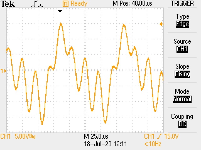

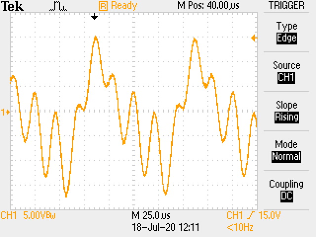

I’m seeing a significant 48KHz component at the output.

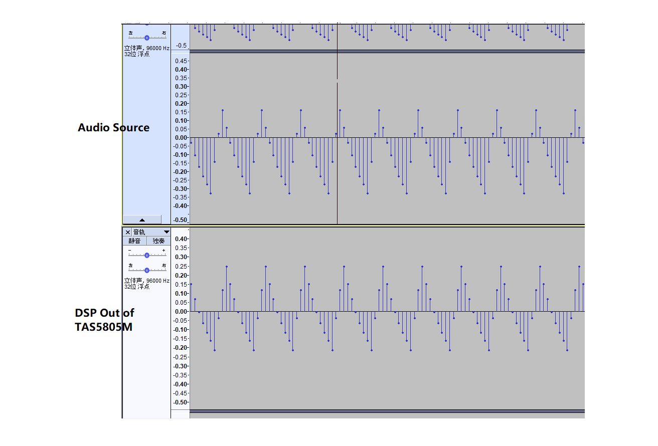

My input is 96K sps. Plotting points, the signal is a monotonic rise/fall.
I’m not using the internal DSP. LC filter, not ferrite bead.
It is acting as if my 96K input is being decimated and processed at 48K. Is this the case?
How might I reduce the 48KHz component? Alternate component?
