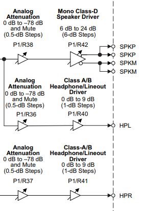

    However, I am confused about controlling the volume for the:
    1- Headphones, left and right channels
    2- The speaker
    Would you please give me the registers I need to use to adjust the volume?
    Thank you.
    Mohammad
  • Hi, Mohammad,
    I'm glad to read that you got good results with the script. Regarding the output gain, the registers associated to the volume are listed below:
    Speaker attenuation block (0.5dB steps): Page 1 / Register 38
    Speaker gain block (6dB steps): Page 1 / Register 42
    Left headphone attenuation block (0.5dB steps): Page 1 / Register 36
    Left headphone gain block (1dB steps): Page 1 / Register 40
    Right headphone attenuation block (0.5dB steps): Page 1 / Register 37
    Right headphone gain block (1dB steps): Page 1 / Register 41
    For more details, please consult the picture below:

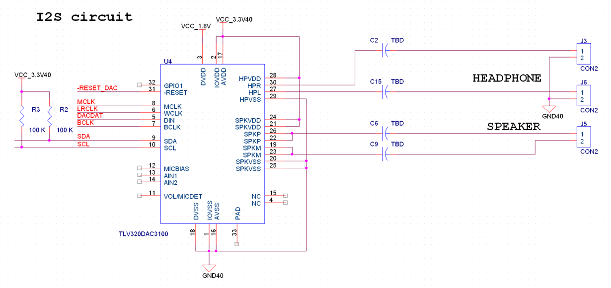

  • Here is the schematic I am using. Please let me know if you see any issues with it.
    Thank you
  • Hi, Mohammad,
    Thank you for providing the details about your testing and the schematic.
    Regarding the schematic, I don't see anything that should be modified. I would just suggest to remove the output capacitors C6 and C9. The speaker output doesn't require of them.
