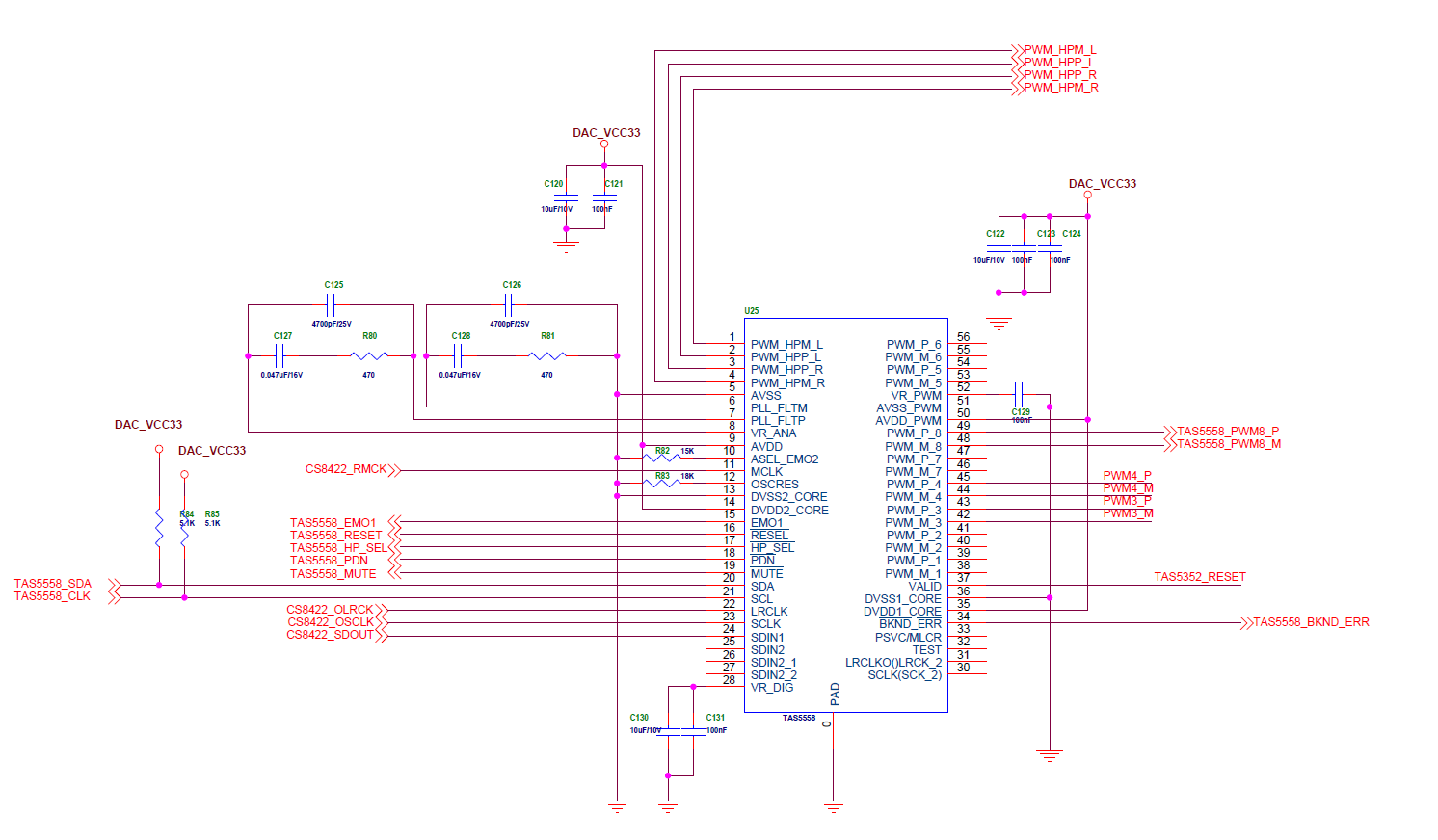

TAS5558 has been able to play music via USB or Bluetooth, but the TAS5558 chip is so hot that I can’t touch it with my hands. Is there a problem with my design? Help me see the circuit.
Hi Marco,
As for the schematic, it's suggested to short pin 32 TEST to GND, and Pin 29 is missed even it's float.
BTW, please confirm the TAS5558 functions are working in your side, and thermal pad is well soldered to PCB board.
Hi Marco,
I assume you are using the same 3.3V to power the different supplies of the TAS5558, could you please check the input current on the 3.3V rail?
Let's check if the power dissipation is normal.
BTW, does the exposed thermal pad under the package well soldered on the PCB board?
Thanks!
Sam
