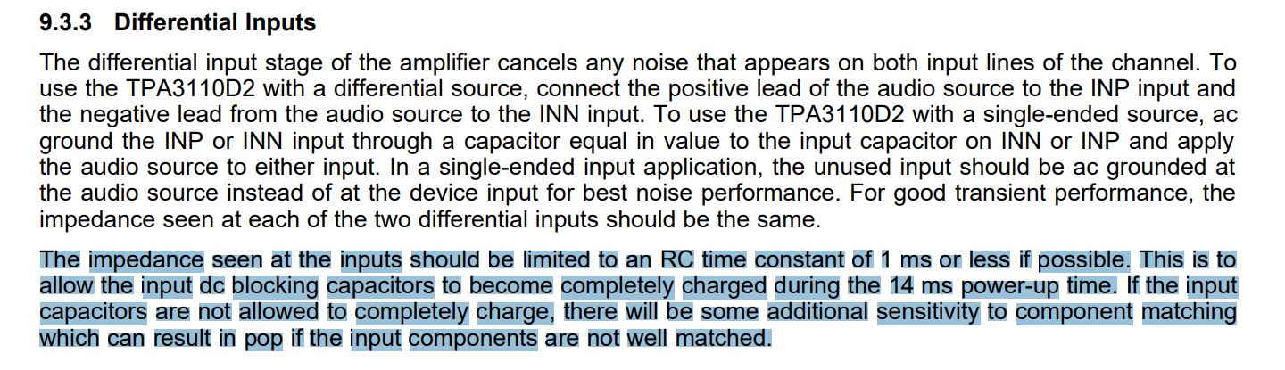

Hi team,
My customer meet a problem when use TPA3110D2, that is there will be some pop noise when change the logic level of SD pin.
And their  input  is single ended input. Do you have any suggestions to solve this problem?
