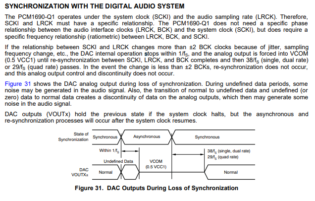

Hello Team,
I have question as below. Can you please support?
Q. For AMUTE[3:0], what is the asynchronous detect?
Q. For AMUTE[3:0], Does the DAC disable command means OPEDA=1?
Q. For OPEDA[3:0], Can we program SRDA during the OPEDA=0000(Normal operation)? Or should we set the OPEDA=1111(disable) firstly then program each setting?
