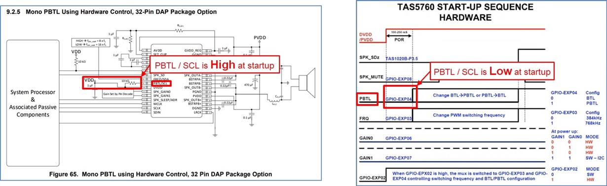

In rare cases, the SPK_FAULT signal is asserted low when the power is turned on at low temperatures.
Customer designed PBTL mode with hardware control, but it seems to be booting in BTL mode.
The SPK_FAULT signal is likely to be asserted low because an overcurrent error has occurred due to an output short circuit.
So I have a question.
I confirmed e2e.(e2e.ti.com/.../626902)
In the following sequence, DVDD and PVDD will start up and POR will operate.
If the Configuration pin is stable after 100-250ms, you can read each status.
Is this understanding correct?
Also, which of DVDD and PVDD triggers the POR?
When driving a POR circuit, the Slew Rate of the power supply may be an issue.
Are there any restrictions on the slew rate of the power supply?

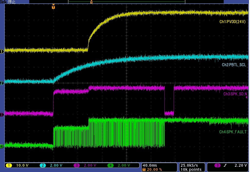

  • Hi Sam-san,
    Sorry for the late reply.
    Thank you for your answer.
    The customer has done various verifications.
    The PBTL_SCL pin is pulled up by DVDD with 10kΩ.
    PBTL_SCL goes High as soon as the DVDD boots.
    In this state, sometimes it doesn't work..
    SPK_FAULT is asserted Low.
    If a 1.0uF capacitor is attached to the PBTL_SC pin, SPK_FAULT will not go low.
    It works correctly.
    If you slow down the input of PBTL_SCL from DVDD, it works correctly.
    I think there are restrictions on the input of DVDD and PBTL_SCL. Are there any restrictions?
    And why does this happen?
    I would like to know the mechanism that causes problems when using such a startup sequence.
    Is it a problem to attach a capacitor to the PBTL_SCL pin as a countermeasure?
    Can I install a capacitor?
    Ishiwata

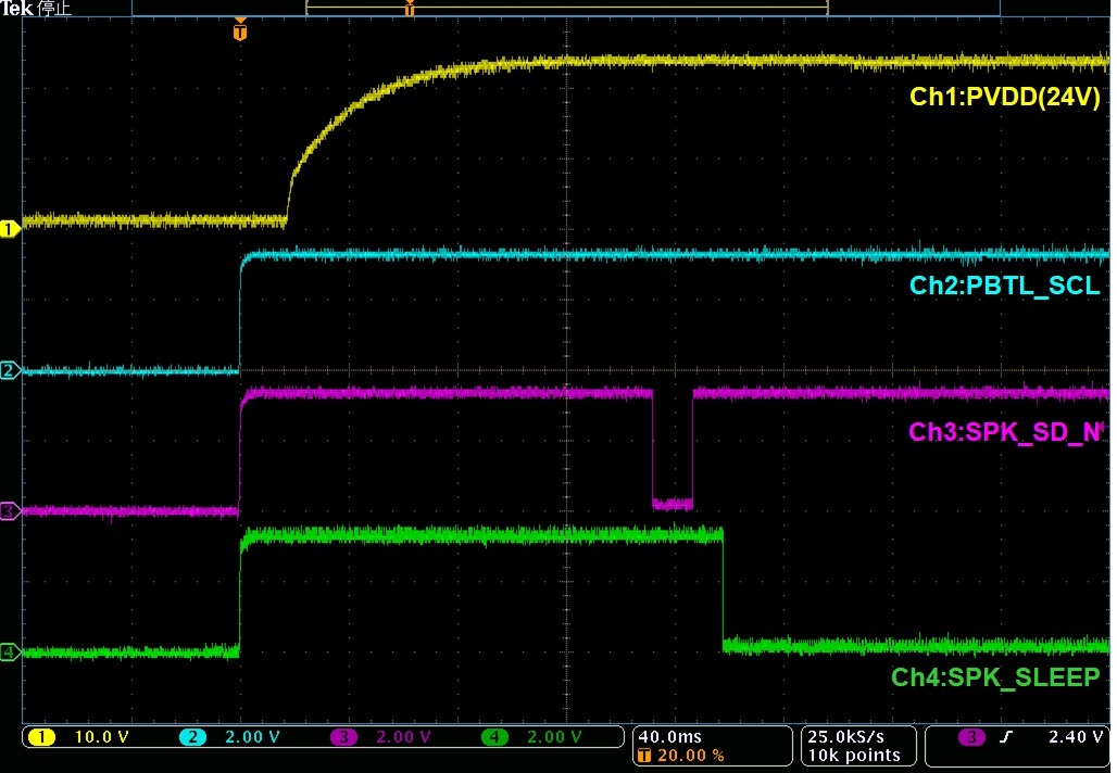

  • Hi Sam-san,
    PBTL_SCL has been pulled up to DVDD (3.3V).
    The waveform is as follows.
    If PBTL_SCL does not have a capacitor, SPK_FAULT is asserted Low.
    If PBTL_SCL have a capacitor, SPK_FAULT is High.
    PBTL_SCL starts up normally when it starts up with a delay.
    Ishiwata

  • Hi Sam-san,
    Thank you for your reply.
    Check the waveform below. SPK_SD is set to Low for 5msec or more.
    SPK_FAULT is still asserted to Low.
    Do you know the cause of this issue?
    Ishiwata

  • Hi Sam-san,
    Even if DVDD and PTBL_SCL are started at the same time, it works normally, but in rare cases it does not work properly.
    I think POR may not work properly. Please tell us your thoughts.
    The customer also solved the problem by installing a 10kΩ pull-up resistor and 4.7uF on the PTBL_SCL pin.
    In this case, it works normally without failure.
    Is there any problem with installing a 10kΩ pull-up resistor and 4.7uF on the PTBL_SCL pin?
    Please check.
    Ishiwata
  • Hi Ishiwata-san,
    Based on current test results, I agree with you that the issue is related to the POR and hardware mode detection. Could you explain that how SPK_SD# configured? Is it derived from DVDD or a GPIO?
    There is no problem to add a R-C filter to insert a delay between PBTL and SCL.
    Thanks!

    (1)There is a difference in the PBTL / SCL pin between the hardware mode reference circuit on the datasheet and recommend Power-on sequence.
         Customers are asking for their views on this difference.
         In the recommended power-on sequence, the PBTL / SCL pin goes low during the POR period, which is inconsistent with the schematic in the data sheet.
         Please tell us your opinion
    (2)Also, Will problems occur if PBTL and FRQ are only pull-up processing?
    (3)In the TAS5760M internal block diagram, there is "Internal Low Voltage Regulators" at the end of the DVDD input.
         Is there a regulator related to the PBTL / SCL pin?

  • Hello Ishiwata-san,
    For Hardware Control mode for Mono PBTL, the schematic on the datasheet where PBTL is pulled to HIGH at startup is the expected and recommended behavior.
    Luis
