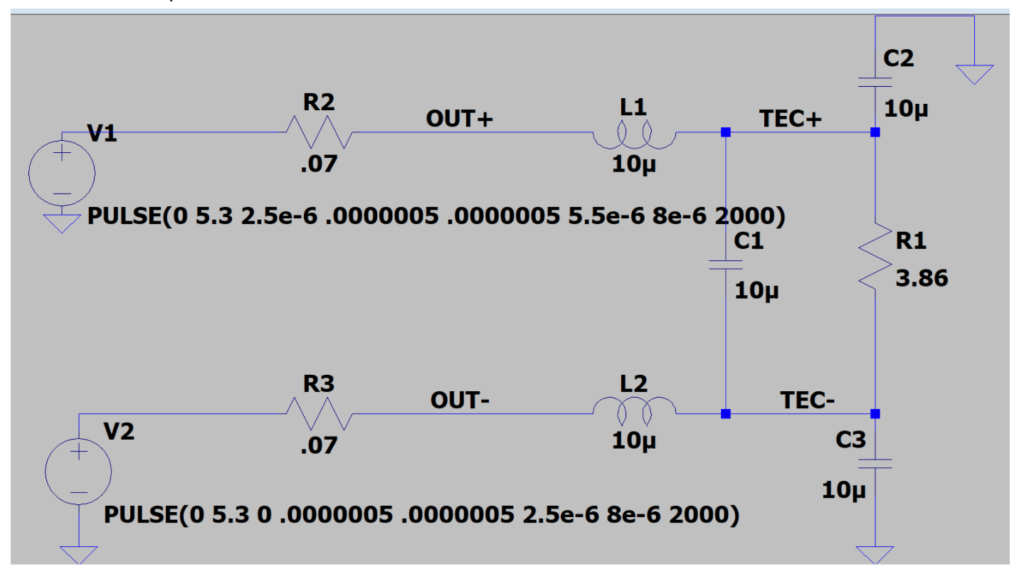

    Yes, our input PWM is running at 100kHz, which seems like plenty.  I don't have any real clear scope shots of the TEC outputs.  I lack a differential probe and triggering has been fussy due to the transition ringing.  However the peak ringing voltages I do capture are pretty consistent with the LTSpice model for the LPF I made.  We've tried two different TECs on this driver circuit,  The 1.8(ish) Ohm @A Diode package TEC and a nominal 12V 3.8 Ohm 2" square TEC which also exhibits the immediate 0,0 overcurrent on powerup using 5,5V.  Here is the LTSpice model for the LPF where R1 is the TEC load, and R2 and R3 represent the datasheet MOSFET resistance for the H-Bridge drivers, which the block diagram shows as the location where the internal over-current sensing takes place:
    PVDD is 5.5V, so the 100kHz square wave for V1 and V2 w 70/30% duty cycle is modelled at 5.3V for the internal drop:

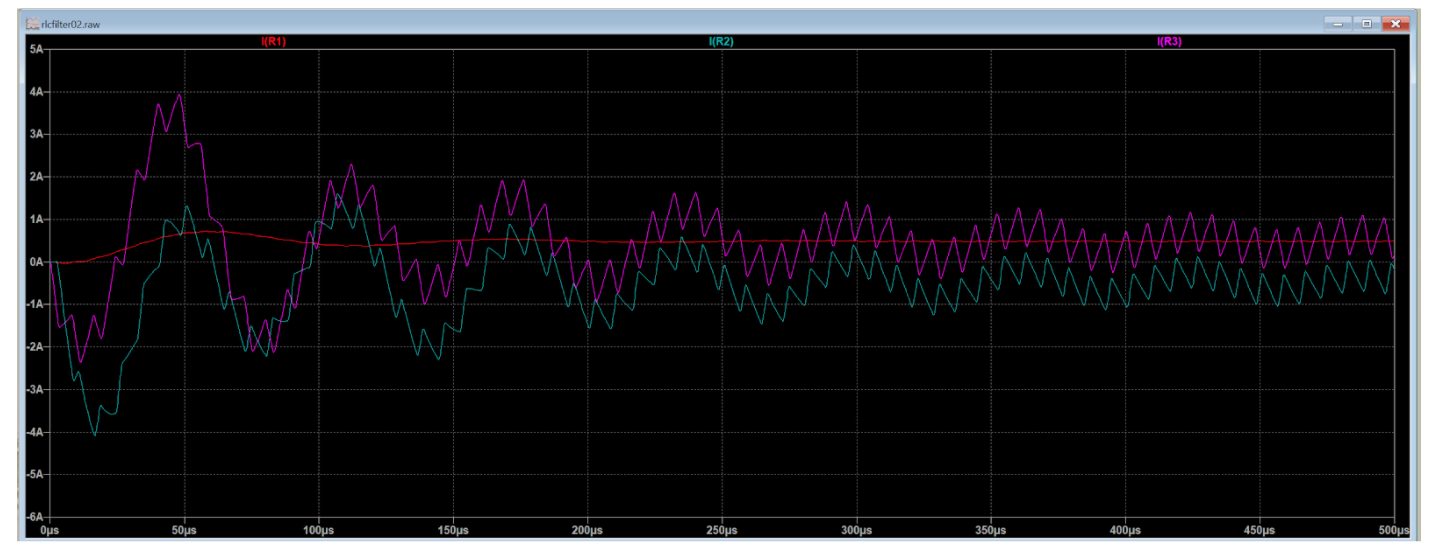

    If we put the LTSpice current probe on R1 and R2, here is the current ringing we see at each transient at 5.3V :
      The initial current ring pulse at 20 and 50us just touch + and - 4Amps then flattens out to the steady-state ripple current.  Our working theory is that this initial ring pulse is tripping the internal 4A OC limit.  This causes V1 and V2 to go Hi-Z for 3-5us before trying again and we get another ring which trips the OC again and so on.  During this OC mode the two outputs move almost completely in phase and no significant current is supplied to the TEC as verified by an in-line ammeter.

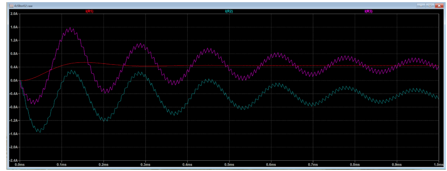

    As I said, we can get this to work if we decrease PVDD to below 4V.  Another way we were able to get it working was to increase the two wire-wound inductors to 68uH.  This also significantly decreased the max steady-state TEC current we can supply and produces an LTSpice transient trace like this:
    The initial transient current is now just 1.6A max but the steady-state TEC supply current goes all the way down to 500mA.  With a 3.3V supply and 10uH we can get the current up to about 1.6A max.  Ideally we'd like to be able to supply the rated 2A TEC current for maximum cooling, but increasing the PVDD voltage trips the OC protection before we can hit that.

  • Hi Dan,
    Do you also have C1 in your board layout? Could you remove it and see if it works?
    I'll continue to think of other possible reasons this could be happening.
