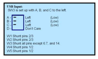

Hi
  I got one PCM510xEVM-U and  I'd like to convert USB audio streaming to analog output,
After booting up with "PCM5101_Init.txt" and then I load and run "PCM5101_USB Playback.txt",
but no output  from the analog (RCA) connector?
What did I do wrong?
    Can you confirm that you have selected the USB device as your audio output device in Windows?  In addition you can use the CodecControl software to change the inputs.
    In addition, note that the jumper configuration must be set when switching inputs.
    Thanks!
    Paul
