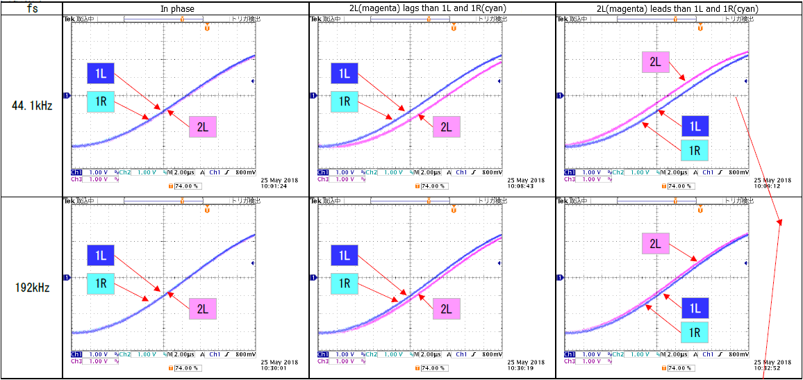

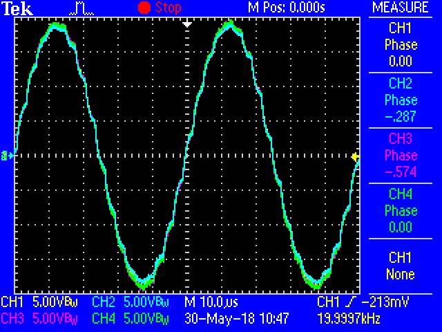

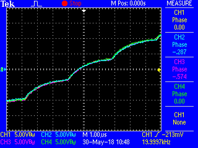

A customer pointed out PCM5102A has a drift of Group Delay.
He tested using two PCM5102A, he inputted same 20 kHz sine wave signal data and clocks to them.
1L: PCM5102A-1 Left channel Output (blue)
1R: PCM5102A-1 right channel Output (cyan)
2L: PCM5102A-2 Left channel Output (magenta)
His questions are the reason why Group Delay drifts and whether the other DACs also drift.

  • Hello Ito-san,
    Is this just drift over time or is there also some temperature change included in this capture (either external influences to temperature or board-level self-heating over time)?
    I will need to check in on the group delay differences in the document.
  • Kevin-san,
    Thank you for your reply.
    I also tested whether the group delay of PCM5102A drifted, using two PCM5102EVM-U boards. I could not find the drift at all, and 4 channel outputs were completely in phase.
    The difference between our customer's measurement waveform and mine is including or not including x8 interpolation frequency signal. His LPF frequency response may be very sharp. Generally, a sharp LPF has a peak of group delay around cut-off frequency. So, I will suggest to him test again without his LPF.

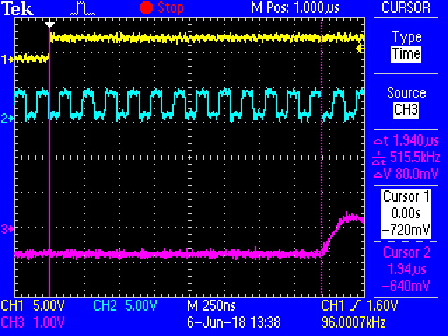

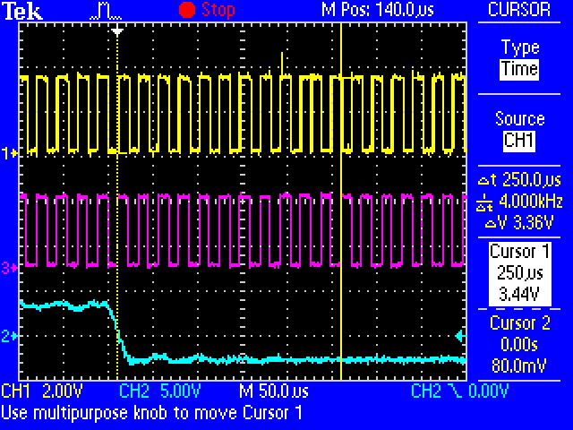

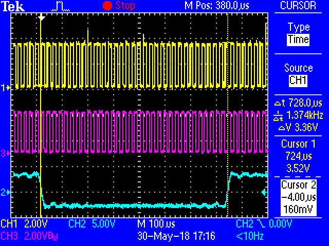

    I have measured PCM5102A group delay using square wave I2S signals. The specification of square wave is as follows.
    Sample rate: 44100 Hz
    Data depth: 16 bits
    Signal: 689 Hz, 0dBFS square wave
    (toggled 7FFFh/8001h per 32 sample periods)
    Phase: Reverse phase between L/R channel
    I2S Left channel data is valid after the next LRCK falling edge, Right channel data is valid after the next LRCK rising edge. I think that the starting point of group delay measurement should be the rising edge of 1.5 LRCK clocks after from DIN bit pattern changed.
    CH1: DIN (yellow)
    CH3: LRCK (magenta)
    CH2: OUTL (cyan)
    My measurement of PCM5102A total group delay including x8 interpolation filter delay was 21/fs.

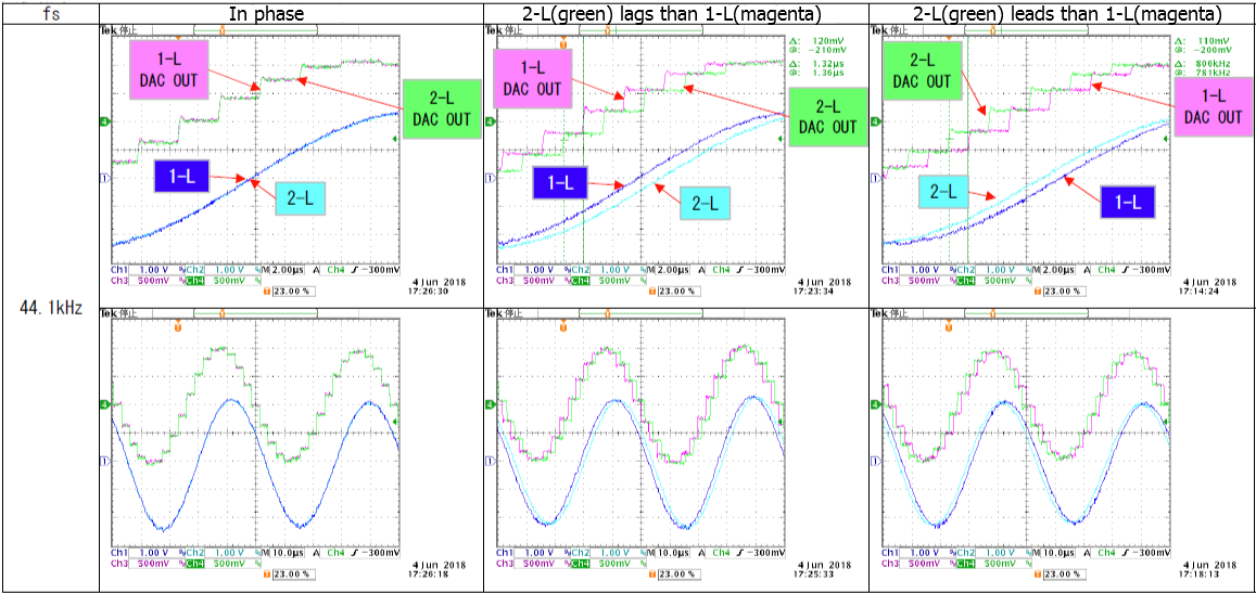

  • Duke-san, and Paul-san,
    Thank you for your replies. Our customer sent us measurement wave form shown below today.
    According to his note under the wave form, the phase between both devices does not fluctuate during DAC operation. DACs seem to start operating with one of upper three types phase wave form.
    I requested to him the information of SCK/LRCK/BCK settings. And I suggested tune the dumping resistors of these clocks.
    Akio Ito

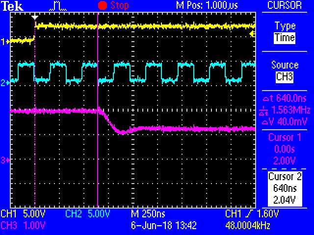

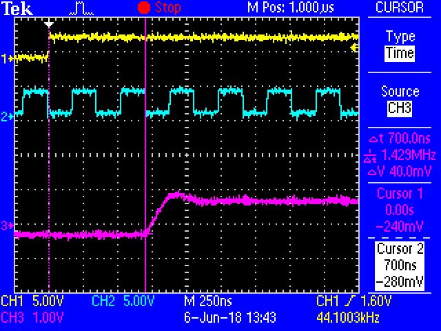

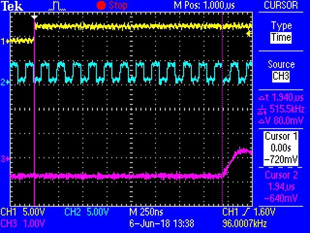

    I did repeat experiments with his clock settings by AudioPrecision COAX output, PCM9211EVM-U DIR to 4-wire serial output and PCM5102EVM-U. When the fs is not changed after power on, DAC output step timing to LRCK seems to be always same position as shown below. But if once the fs is changed, DAC output step timing to LRCK is not same position.
    CH1: LRCK (Yellow)
    CH2: BCK (Cyan)
    CH3: OUTL (Magenta)
    Akio Ito

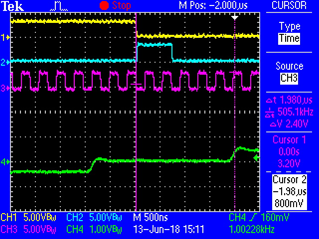

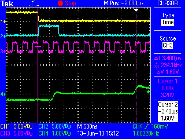

  • Paul-san,
    I did repeat experiments with our customer's clock settings again by playing a ±1/2FS square wave wav file.
    Playing only the fs=44.1kHz wav file repeatedly, I found four cases of output delay time, 5-1/2, 6-3/4, 9-1/2, 10-3/4 BCK as shown below.
    CH1 (Yellow):     LRCK   44.1 kHz
    CH2 (Cyan):       DIN      C0010000h / 3FFF0000h
    CH3 (Magenta): BCK     64fs, 2.8224 MHz (Magenta)
    CH4 (Green):     OUTL   w/o LPF
    Akio Ito
  • Paul-san,
    I did repeat experiments again, today too.
    I got 44.1k, 48k, 96k and 192k fs datum respectively with delay dispersion of 7.5 BCLK equivalence, as shown below.
    May I regard the dispersion of output delay as within 8 BCLK clocks when Serial Audio Data is 64 BCLK per sample ?
    Akio Ito
