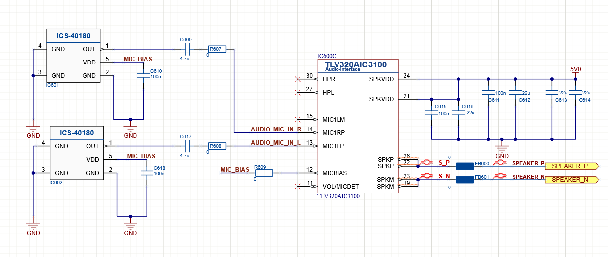

The mic's input voltage is connected directly to the MICBIAS pin with 100n caps to ground. The only other external parts are 4.7u caps between the mic's outputs and the corresponding input pins of the codec.

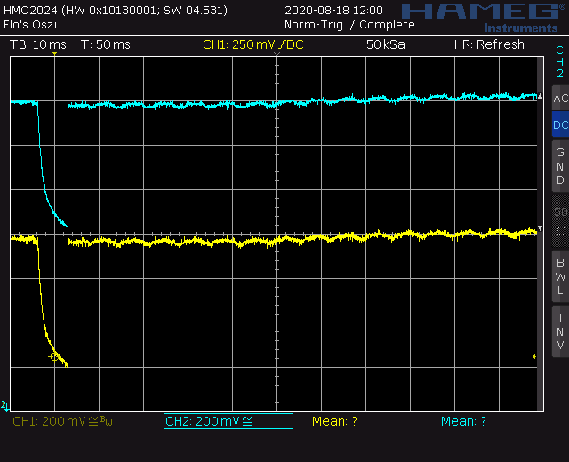

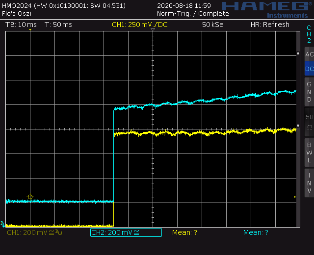

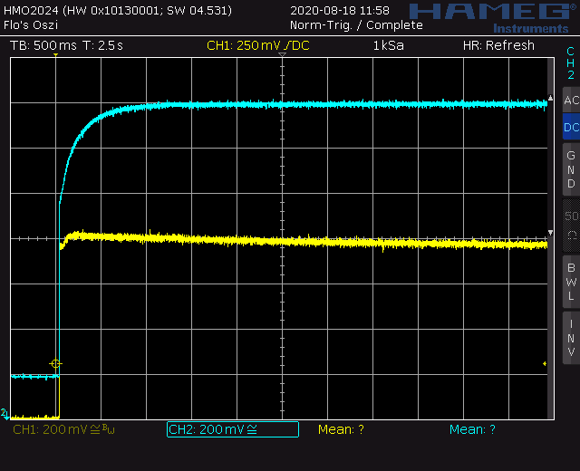

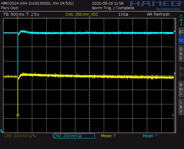

I noticed that after setting the ADC mux the codec applies a voltage to the microphone input that increases further after setting the mic bias. Is that normal behavior? If I disconnect the codec, there's no DC part in the signal between codec and cap but only between mic and cap. If the codec is connected, there are different DC offsets before and after the cap.
Here are screenshots of a software reset without a power cycle, blue is between cap and codec, yellow between mic and cap:
Here's a power cycle:
What I find really odd is that even after the voltages have settled the values I get over I2S continue to be way too high for about two and a half minutes.

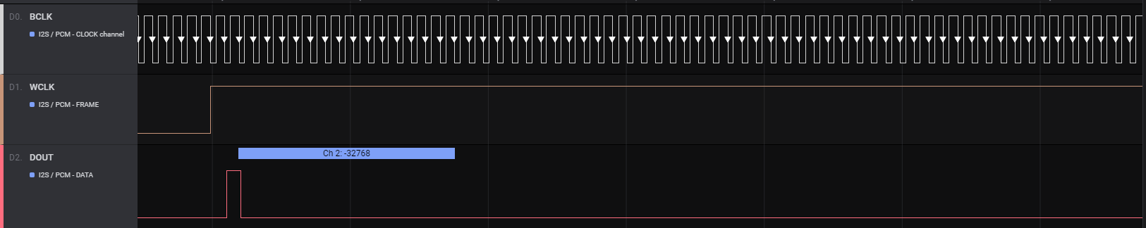

    - scope shots of ASI bus showing BCLK, WCLK DOUT
    From your post, it sounds like there are caps on MICBIAS pin. Theses should be removed as MICBIAS is already a very clean signal and adding decoupling caps can produce unknown behavior.

  • Hi Aaron,
    here is the relevant part of the schematic:

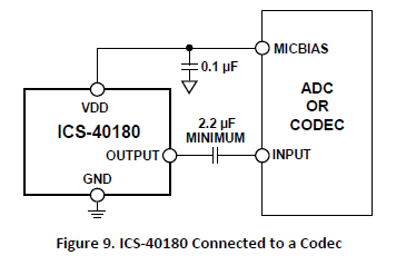

    The caps were recommended by TDK in the microphone datasheet:
    I tried removing them though, unfortunately it didn't help.

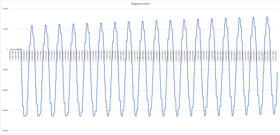

    When I use the mic with a 1 uF cap as the only input with max gain, the problem persists, but seems to improve. It only takes about half a minute until the values are leveled out. But I guess this could also be due to using only one mic or a combination of other circumstances.
    When I use the sine wave input with a 1 uF cap and set the gain register to zero,  the problem seems to be gone. When I export the logic analyzer data into Excel and plot it, I get a relatively clean sine wave directly from the start. The DC offset is gone after about 2 seconds which is totally fine.
    I tried to turn down the mic gain and the values seemed to settle much faster. I thought I tried this before and the problem still existed, only with other values. So right now, without the 100n caps on the mic bias, with 1 uF caps in the mic path and without any mic pga gain, it seems to be working fine. Unfortunately, I will need mic gain to get useful values. Even if I change the mic gain while the system is running, the values will need about half a minute to settle to their new baseline. I tried enabling soft-stepping, but this didn't change anything. So, to conclude, I think the problem is the mic gain. Is there anything I can do to make the values settle faster after turning it up?

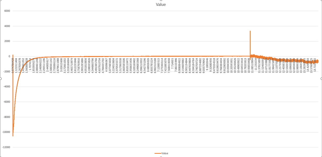

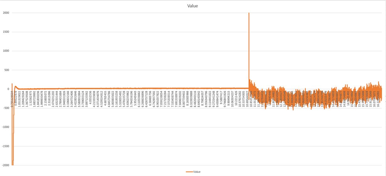

    Correction: I can change the gain on the fly without any artifacts. The problem only exists when reinitializing the codec. So I might just initialize it with a gain of zero and turn it to the max a few ms later. I'll have to try this on another hardware with two mics again though.

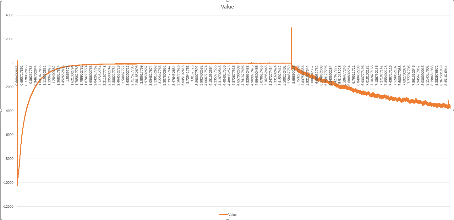

    Edit2: Well, I guess this is not the solution. Here's what happens if I initialize the codec with 0 dB mic pga and turn it up to 59.5 dB after 5 seconds:
    Here's what happens if I turn it up after 10 seconds:
    A bit more useful, but still not very much.

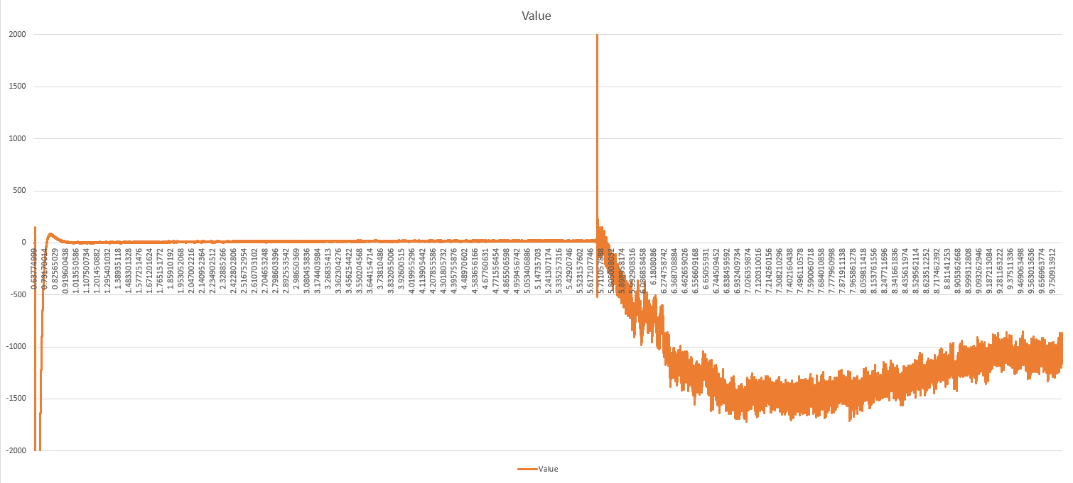

    Edit3: Here are the same measurements with the original hardware, I think we're getting somewhere :)
