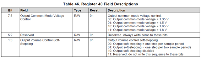

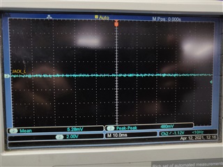

TLV320AIC3109-Q1: One of the Audio codecs doesn't play the audio despite having same register writes.
Part Number: TLV320AIC3109-Q1
The firmware performs same register configurations for the audio codecs. But in one of the audio codec, there is no playback. The non working codec was replaced with the working codec to check whether the circuit is working properly and it works.
The register dump of both are given below.
Working codec :

Please suggest how to resolve this.
