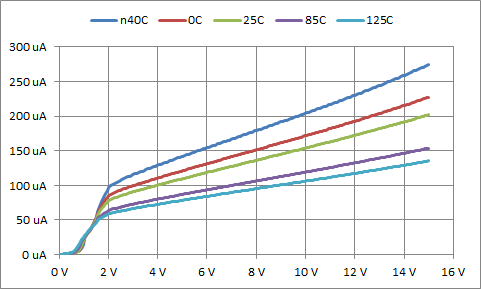

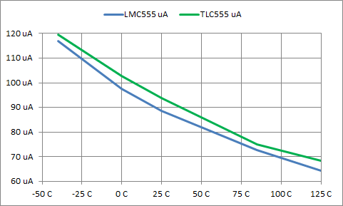

LMC555: Maximum power supply current on high temp
Part Number: LMC555
Other Parts Discussed in Thread: TLC555
We consider to use 555 for clock generation. LMC555  25C power supply current is written in datasheet.
Could we know the maximum power supply current at 125C. We want to compare power supply current between TLC555I and LMC555 at 3.3V.
We need to care about power consumption.
