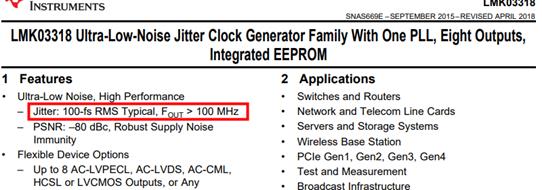

We are considering adding a jitter attenuator because the output of the DPLL for timing synchronization that we use does not meet the jitter characteristics required by the main switch.
I checked the LMK03318, and it says "jitter: 100-fs RMS typical" for the frequency output above 100MHz on the datasheet as shown below.
The clock we will use as input is 156.25MHz, jitter: 280-fs, the required output is 156.25MHz 8 outputs, jitter: 150-fs or less.
Is it possible to use LMK03318 as a jitter attenuator to satisfy this condition?
Or is there another product that is better suited to the jitter attenuator?
Please Check it.
Thank you.

  • Hi Anthony,
    Please provide the phase noise of the 156.25MHz clock, we need phase noise instead of jitter to determine if LMK03318 or other device can help you.

  • Hi Anthony,
    Please use a signal source analyzer to measure the phase noise of the 156.25MHz clock. You can refer to datasheet, section 8.31, Figure 2 for a typical phase noise measurement.
