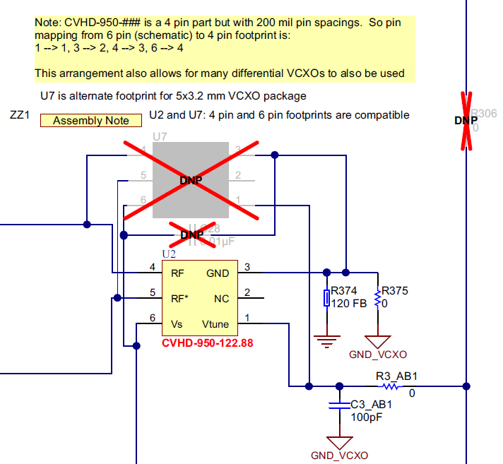

Can you provide the data sheet of the VCXO Y2 which is listed in the BOM of the EVM, please? I cannot find this on the web…

Hello Hans,
I confused between LMK04832 and LMK0482x.
The image I gave above was from the LMK0482x EVM and uses the Crystek CVHD-950-122.88 MHz VCXO. This is a CMOS 4-pin VCXO with 0.2 inch spacing on the pins.
The LMK04832 uses the Crystek 603281. This is a differential (LVPECL) 6-pin VCXO with 0.1 inch spacing on the pins.
The LMK04832 and LMK0482x by proper connections, both the LMK0482x or LMK04832 could accommodate either one of these VCXOs.
Note, here is the schematic of the VCXO from the LMK04832EVM, Y1 is for CVHD-950, Y2 is for 603281. These footprints are overlaid.
