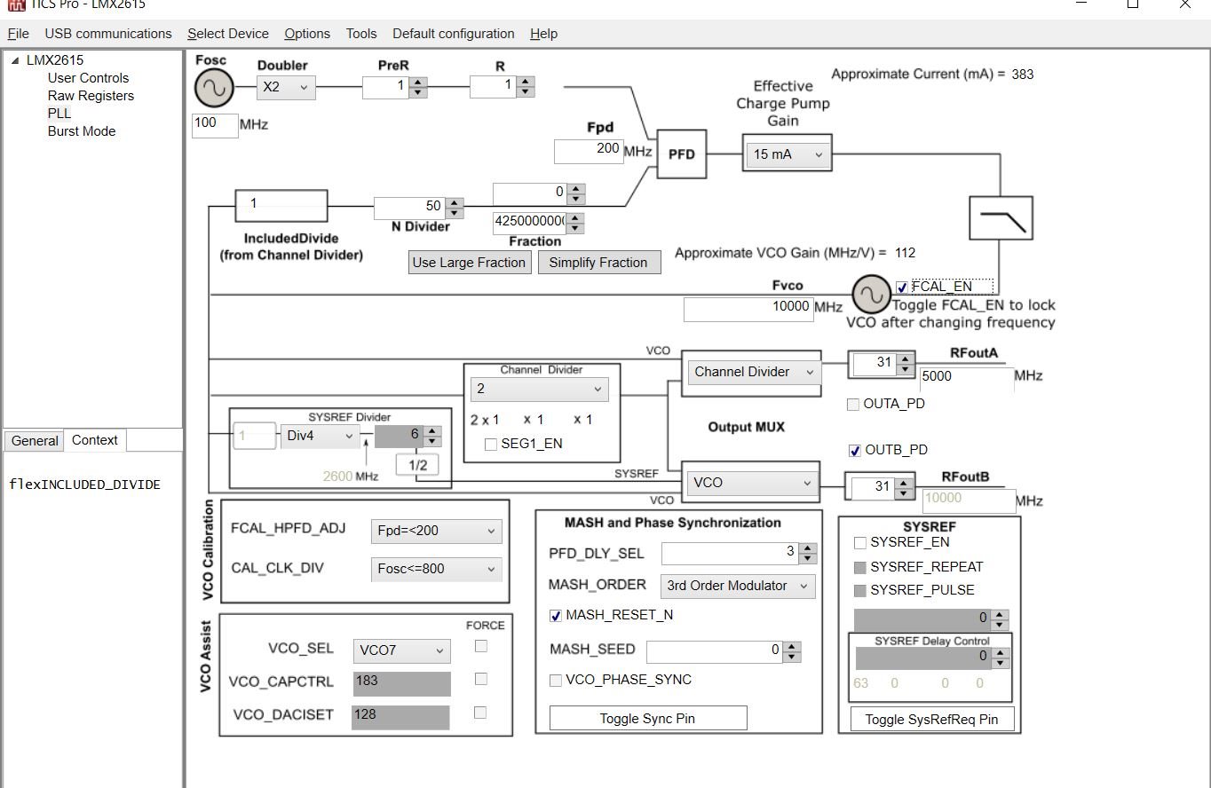

The board is connected to the Reference PRO, which generates correctly 100 MHz (checked via spectrum analyser). The connections to the LMX2615EVM-CVAL are done as described in the manual. The TCIS software is installed (final version). I than load the correct device and additionally set the default values. Normally the lock LED should light up now on the LMX2615EVM-CVAL right? This is not the case. All jumpers are correctly set.

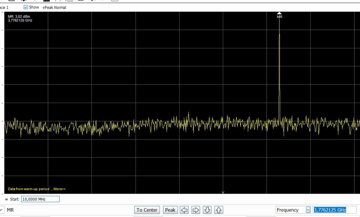

If I change the frequency to, let's say 5 GHz, the board generates a totally different frequency of 3.77 GHz (see printscreen). If I change in small steps, nothing changes. if I change (sometimes) in big steps, suddenly the board generates a signal 500 MHz lower (or higher). It seems the device doesn't respond to the commanded frequency setting.
I already checked the Vtune, and as soon as you send a command, the Vtune gets active.

  • Dear Vibhu
    Thanks for your reply.
    Attached you can find the setting in TICS Pro, as well as a printscreen of the spectrum analyser. As you can see I asked for 5 GHz, and the device outputs 3.77 GHz. Changing the frequency in small steps (let's say of a few 10 MHz) doesn't change the output frequency of the device. Even asking to generate 4.9; 4.8; 4.7; 4.6 or 4.5 GHz (or 7.5 GHz) doesn't have any impact. The output stays at 3.77 GHz. Each time I toggle the FCAL_EN and make sure no box is highlighted in red or orange.
    Concerning your proposed steps:
    - I toggled already a few times the FCAL_EN. Each time I implemented a change (switch freq, ...) I toggled this box, without any success.
    - The power down check box works fine. After I toggled it and try to reload the registers the same output frequency appears (not 5 GHz, by 3.77 GHz).
    - Communication should work normally, because the device clearly reacts on my commands 'dfr. the power down command), but not in a good manner. I separately measured the reference Pro, and it clearly puts out a 100 MHz signal.
    Hopefully this helps.
    Many thanks for your effort.
    Best regards
    Jurgen

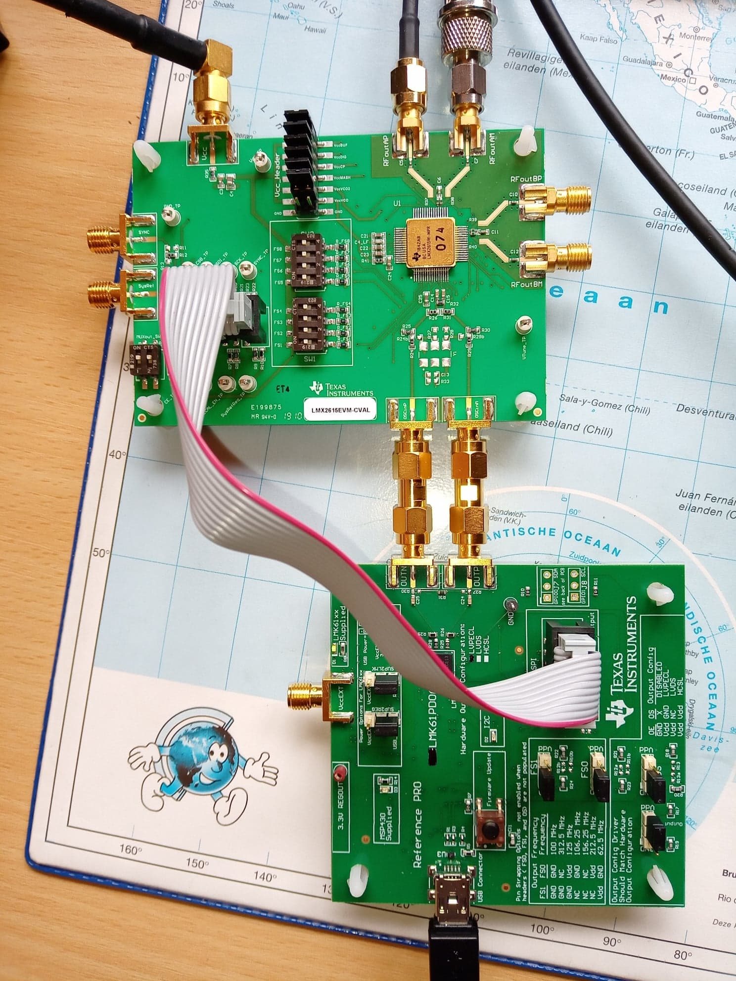

  • Just for completeness I added a picture of the setup. The upper right SMA connector is connected to a 50 Ohm Dummy load. The left SMA goes to the spectrum analyser. The bottom SMA's are connected to the Reference Pro. The upper most left SMA goes to the power supply. I already try to change the spectrum analyser and dummy load connections, but without any success.
    Best regards
    Jurgen
  • Hi Jurgen,
    Could you remove R32 (close to OSCin pins) and try again?
    I think we have forgotten to remove R32 in the BOM, since both OSCin pins have 50Ω shunt already.
