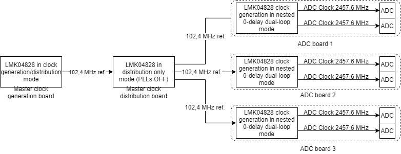

We're facing an issue trying to synchronize data converters on multiple boards.
We have several boards, each of them with two high-speed JESD-204B ADCs each. These boards have an LMK04828B as their clock generator/distributor for both ADCs. The ADC sampling clock is 2457,6 MHz, sent directly from the LMK04828B, output 10 for one ADC, output 12 for the other.
These LMK04828Bs on the ADC boards are configured in nested 0-delay mode. PLL1 has a Fpd of 1024 kHz and uses a Crystek CVHD-950 122,88 MHz VCXO. PLL2 has a Fpd of 122,88 MHz, with the reference coming directly from PLL1. The loop is internally closed from output 6, at 102,4 MHz, which is the lowest frequency for any output.
The PLL1 reference for these LMK04828Bs is external at 102,4 MHz and comes from a master clock distribution board, which also uses an LMK04828 in clock distribution mode (what comes from CLKIN1 goes to every DClk output, and whatever comes from CLKin0 is broadcast to the SDClk outputs.
The input from the master clock distribution board comes from the master clock generation board, which again uses an LMK04828B, which among other things generates the 102,4 MHz reference and SYSREF that goes to the clock distribution board and is distributed to every ADC clock.
Something like this:
The SYNC/SYSREF signal follows the same path. The master clock generation board self-synchronizes its outputs, then it broadcasts a SYNC pulse via the clock distribution board, causing the simultaneous alingment of all ADC board clock outputs, and then everything is reconfigured to switch to SYSREF functionality, and the JESD link goes up witth deterministic latency and our ADCs get time-synchronized and start sampling.

  • Hello Derek,
    Thanks for your answer, I forgot to update this post but about 1 hour after posting this it came to our mind that PLL1 could be a concern, and surely enough that was the root cause of the problem. We have already solved it, and I'm going to tell you how to get your opinion.
    Long story short, the first LMK04828 in the master clock generation board can take its reference either from a very high quality OCXO or from an external source which might be clean or not too much. In case of external reference, it goes through a special circuitery to convert whatever clock format you throw in to LVPECL with the sufficient slew rate without degrading the clock too much. The PFD of PLL1 for this one is 80 kHz and the loop bandwidth is set to 50 Hz.
    The LMK04828s in the ADC boards were designed with a 20 Hz PLL1 filter, and that was causing the inter-board clock wander. Apparently it was too narrow and it didn't allow the ADC boards to track the close-in phase noise of the reference coming from the clock distribution board well enough. They were filtering the reference "too much" causing cummulative low frequency jitter effects between boards. In retrospective, we actually copy-pasted the design for this one from a different board and didn't think too much about it at the time, but it now seems like it was a poor choice.
    We tested and saw that doubling the bandwidth of the PLL1 loop filter for the ADC boards halved our wander issue. In the end, we set to a 900 Hz PLL1 loop filter (swapped components) and the issue is completely gone, now the ADCs within a board behave the same as ADCs between boards, staying within 0,02º RMS. We designed the filter for the highest CP current and with enough margin so that we can tweak the bandwith down if we want. We also upped the PFD from 1.024 MHz up to 34.3 MHz.
