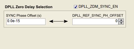

    I noticed an anomaly on the software though:
    The value of the time calculated in the delay window by the gui is twice that of what I measure with an oscilloscope.
    If the gui tells me 300nec I measure 150nsec
    GPS_neo7_48Mhz_100hzpps_400Hz.tcs

    have you news for the delay calculation?
  • Hi Luca,
    Sorry I haven't been able to look into this. Let me try and check it by next Tuesday.
    By the way, I did find that LMK05318B's "backward compatible" mode has a software bug so that DPLL_LOFL cannot be cleared. We'll fix that asap. For now just use the LMK05318 GUI.
    Hao
  • Hi Luca,
    I checked that the calculation for the phase offset is correct. We have limited lab access right now to perform this test, but this have been logged into the tracking system. Thanks for the feedback.
