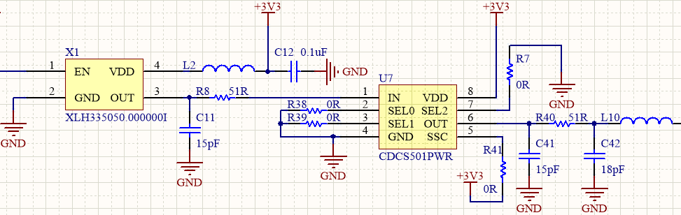

When the clock is turned off through an enable line, the clock output that feeds into the CDCS501PWR is low. During this, the output of the part has a pulsed oscillation.
I have tried making sure that the signal fed into the CDCS is pulled low and pulled high. The same problem occurs on the output either way. Checking with the oscilloscope this problem does not exist on the input of the CDCS.
I have removed the 18pF and 15pF capacitors on the output. I have removed a ferrite bead on the output. I have removed the resistor on the output. I have even tried pulling the output up with a 1k resistor up or down. I always have the same output when the clock is disabled with every individual change.
This problem does not exist when the clock is enabled.
Any help is greatly appreciated.

    Just so I understand better, the clock here is the XLH335050 component?
    So when it's providing and output which goes into the CDCS501, the CDCS501 shows you the same output - as expected.
    When you change the enable line on the XLH335050 (presumably disabling it's output), CDCS501 shows a pulsed output? You have probed this and you know for certain that there's no input clock going in and you have forced a low or a high, and the CDCS501 still shows the pulse. What is the voh of the pulse?
    This is an older device and the information on it is very limited, but from what I can tell the whole spread feature is essentially disabled once you pull SSC high - so what benefit is it providing in your system?

  • Yes, XLH335050 is the clock being used.
    Yes, when there is a signal applied to the CDCS501, I get the expected signal on the other side.
    Yes this is correct, I have probed both input and output at the same time while attempting to pull the line high and low. ~3.2V.
    Sorry I had not caught that when I posted up the schematic. The part for pulling SSC high is actually not populated on the board and that should show up in the schematic with an NF over it but the software I use sometimes decides not to do that.

    Does it matter at all whether the clock was ever provided or not? As in do the pulses only occur if the system had ever gotten an actual clock vs if you powered up in disabled mode?
    Also is there an inductor on the output pin?

  • The behavior is the same before the clock signal is initially provided and after the clock signal has been provided but then disabled.
    There was a Ferrite bead on the output of the device. This was removed while trying to debug this issue.
