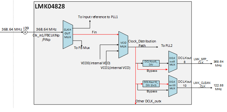

Hi Vibhu,
Thanks for the inputs.
1. The device functional modes should be shown as attached snapshot.
Dual PLL with CLKin1(External VCO) mode. CLKin1 to be 368.64Mhz.DCLKout8 to be 368.64Mhz. DCLJout10 to be 10Mhz or 122.8Mhz.

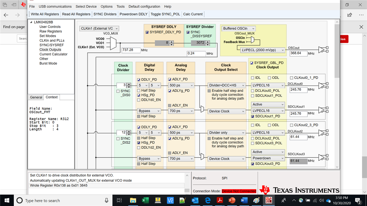

2. But, in TICS Pro in Clock Outputs option, I could not able to set Clkin1(Ext VCO) as 368.64Mhz as shown in snapshot. it is setting to different value(737.28Mhz).
Hello Srinivasa,
So it looks like you intend to use single PLL mode, what is your OSCin frequency? This needs to be set to use this mode correctly. PLL2 output frequency will only be set to frequencies that can be generated from the Fpd frequency which is dependent on the OSCin.
If this is not the case, do you want to use distribution mode? OSCin is not required but you cannot use an external VCO, instead you have an external clock source and use the LMK04828 as a buffer with dividers.
Vibhu

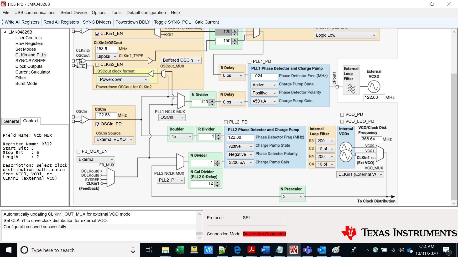

Hi Vibhu,
Thanks a lot for support.
With the OSCin as 122.88Mhz and prescaller 3, CLKin 368.64Mhz is coming as shown in the snapshot.
Single-loop with external VCO mode (vs) Distribution mode. what exactly makes difference?. is it that the VCO corrects the clock in feedback path in the external VCO mode?.
Without the OSCin, just by applying CLKin, in Distribution mode, then what is the LMK functionality, is it just to clean jitter?.
If the register 0x140 value is x0. will it give any information on modes?.
Hello Srinivasa,
I'm glad that helped solve the problem :)
In single loop with external VCO, the external VCO serves as the VCO for PLL2. You still need OSCin as the input to the PLL2 phase detector and the PLL2 is active. The external VCO requires an external loop filter. The tuning voltage for the VCO comes from the CP out pin through the loop filter to the VCO and the output of the VCO goes into the device via the CLKin1 pins. The device is still a PLL. See section "9.4.4 Single-Loop Mode With External VCO" of the datasheet.
In distribution mode the LMK04828 is used just as a buffer. PLL2 is powered down. You do not need an input at OSCin. Please see "9.4.5 Distribution Mode".
