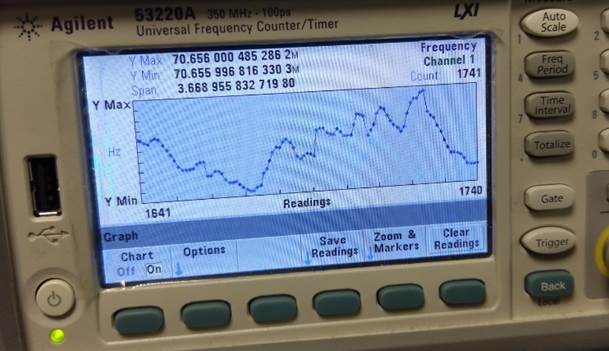

Customer used our LMK61E07 for BCM65408 70.656Mhz clock and its spec mentioned like below < 1Hz
However, from their measurement, the stability 3.66Hz looks failed. Would you please provide any suggestions about it? Can LMK61E07 meet their need?

    I have received similar question with same measurement technique/equipment on LMK61E08 (which is the same just with different PLL N divider fractions). The excerpt you have pulled doesn't seem to be from the datasheet, correct? I don't see it on there...
    Why is the assumption that device can hold <1 Hz stability? This is not OCXO...
    The total stability of the device is defined as +/- 25 ppm, which would equate to 1000+ Hz. Yes this over temperature and other parameters, but still <1 Hz is not achievable with
