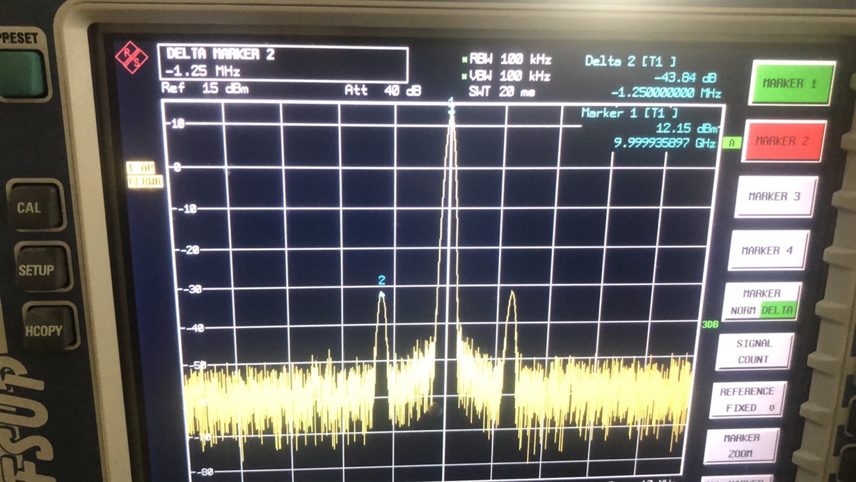

When our customer uses LMX2595 to generate 10GHz frequency, there is spurious at 1.25MHz from the center frequency. What are the possible causes and what should be analyzed from?

The TPS62150 used by the customer supplies power to LMX2595. It is found that the switching frequency of DCDC TPS62150 appears in the output spectrum. Is there any way to filter the switching frequency?
