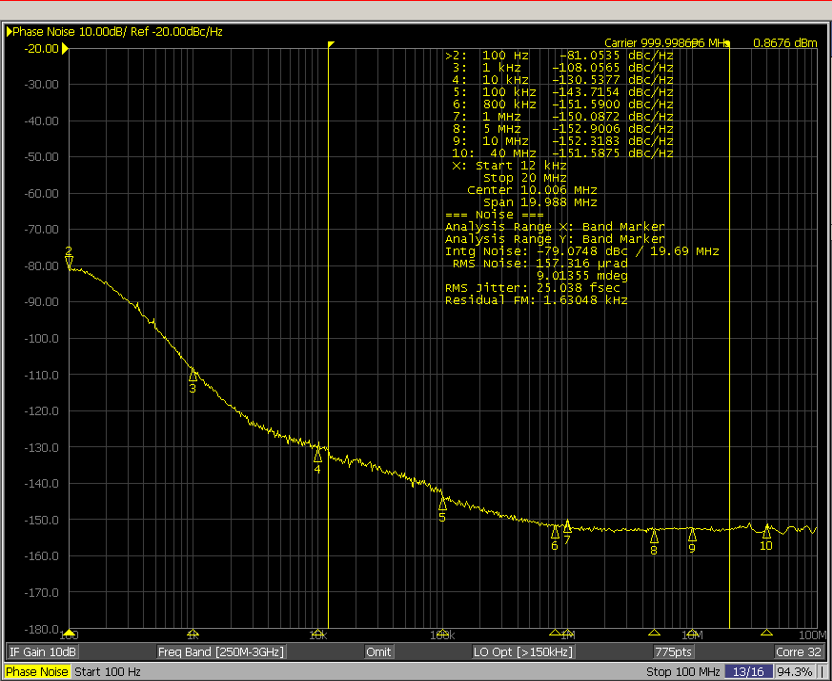

We want to use the LMK04828 in distribution mode (no PLL) with with following parameters:
Input clock = 800 MHz
Output clock1 = 800 MHz
Output clock2 = 200 MHz
Do you perhaps have phase noise diagrams for the above scenario?

  • Hello Piet,
    Below is a phase noise plot for a 1000 MHz output when the LMK04828 is in distribution mode and the input frequency is 1000 MHz. This data is the closest data we have to your scenario.
    The phase noise plot for your 800 MHz output should follow a similar trend to the plot above.

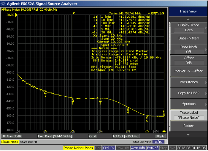

  • Hi Kia
    Thanks for the reply.
    1. Do you perhaps have a more commonly used 245 MHz diagram for distribution mode, or another frequency close to 200 MHz?

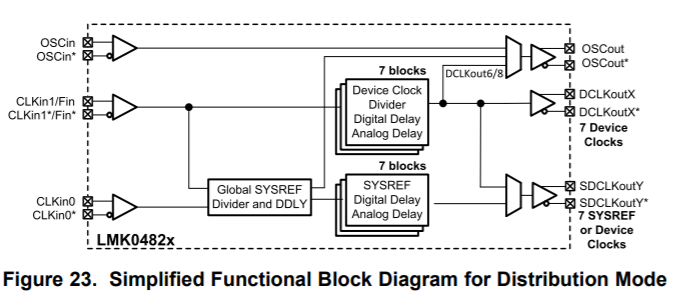

  • Hello Piet,
    1. The best I can provide you is a phase noise plot of 245 MHz for single-loop mode (shown below).
    2/3. In single-loop mode, the only input is OSCin as shown below.
    Since this is the only input, the input frequency is limited by the OSCin frequency range (shown below).
    In dual-loop mode, the only input is CLKin as shown below.
    Since this is the only input, the input frequency is limited by the CLKin frequency range (shown below).
    In distribution mode, there are three possible inputs: CLKin, Fin, and OSCin (shown below).
    The maximum input frequency for distribution mode is determined based off which input is used. For a CLKin input, the maximum input frequency would be 750 MHz as shown above. For a OSCin input, the maximum input frequency would be 500 MHz as shown above. For a Fin input, the maximum input frequency is limited by the Fin frequency range shown below.
    To sum it up, the input type limits the maximum input frequency and a 800 MHz input is only possible when the device is used in distribution mode and the 800 MHz signal is feed into the Fin pin.
    Kia Rahbar

  • Hello Piet,
    Single PLL mode has OSCin as an input (as shown in figure 21 in my last post). The maximum input frequency for OSCin is 500 MHz, so in single PLL mode the input frequency cannot be greater than 500 MHz.
    Distribution mode is the only mode where the input frequency higher than 750 MHz can be used. Distribution mode is the only mode that uses Fin as an input.
    Kia Rahbar

  • Hello Piet,
    In distribution mode, the input frequency is feed into a clock divider and then outputted from the device. Since we are only dividing the frequency in distribution mode, a much higher input frequency can be used. This is why we can use the Fin limit of 3.1 GHz.
    In dual-loop mode, the input frequency is feed into a PLL. If a large frequency is feed into the PLL, the PLL will not be able to lock to that input frequency (due to the limitations of the phase detector frequency and the VCO frequency). This is why we use the CLKin limit of 750 MHz.
