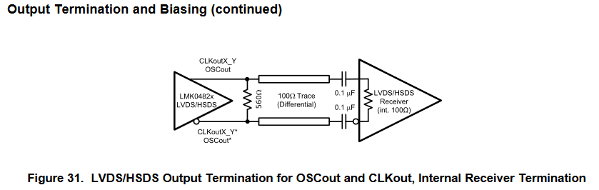

Please let us know what happens if 560ohm is missing from the Figure 31 below.
If external 100 ohm termination is placed on the LMK04828 side of the AC-coupling capacitors, is it not necessary to use 560 ohm as shown below?
Thank you.
JH
