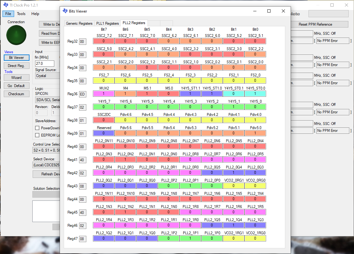

  • Hello Shidara,
    The referenced E2E question is pertaining to decimal values vs hex values of Register 24 within the Bit Viewer.
    This issue has been resolved although resizing the window is not possible.
    Register 15 pertains to all reserved bits and shows value of 0x00 - I don't see an issue with this.
    Register 31 pertains to PLL1_1Q, PLL1_1P and VCO1_1RG. The register resembles the appropriate 2 bit hex value.
    Register 47 pertains to PLL2_1Q, PLL2_1P and VCO2_1RG. The register resembles the appropriate 2 bit hex value.
    I don't see an issue on Clock Pro v1.2.1. Please include image.

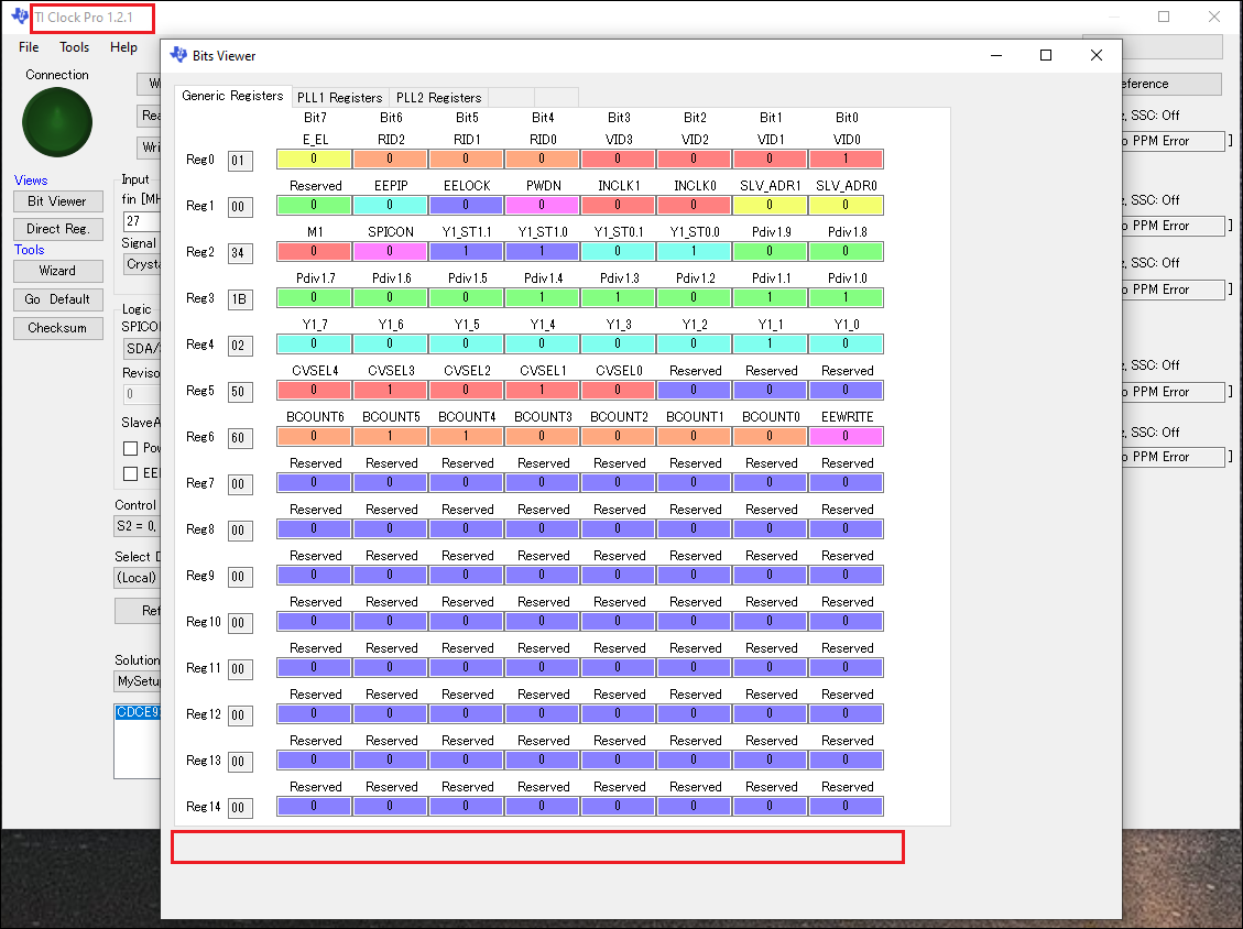

  • Hi Aaron-san
    Thanks for your comment.
    Please point out if my understanding is wrong that below is the capture of ClockPro V1.2.1
    Bits viewer. Should it be displayed Reg15 under Reg14 on this page?
    Shidara

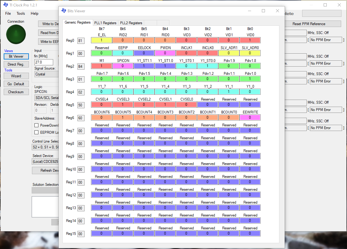

  • Hello Shidara,
    I would try and reinstall this program from ti.com. I'm not sure why your register values are not displaying Register 15, 31 and 47 but I can confirm the same displayed revision is showing these registers.

  • Hello Shidara,
    I have confirmed with other users of this program and they also see these registers. I'm assuming this is a bug. We are also using Windows 10 Pro OS.
    I would recommend using a different machine with a fresh installation of the software. I am not sure if residual files were left on the machine when uninstalled but I would make sure to uninstall all cache that might have residual data.
    Sorry, this seems like a bug to your specific situation, we cannot recreate this event. Could you zip up the ClockPro files and send them over? I want to make sure there isn't anything missing.
