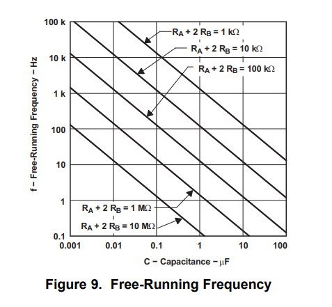

    To minimize errors the customer would operate at frequencies under 100kHz as shown in the Free-Running Frequency plot below. Frequencies beyond 100kHz become more difficult to get good accuracy due to propagation delays starting to play a role. The curve becomes non-linear beyond 100kHz. In order to operate at higher frequencies board parasitic capacitance plays a role. When the timing capacitor is small, board parasitic capacitance may start to play a role and should be accounted for.

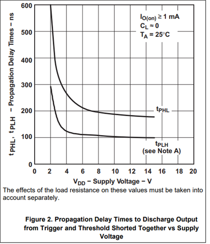

    In addition the propagation delays depend on the supply voltage and should also be accounted for as shown below:
