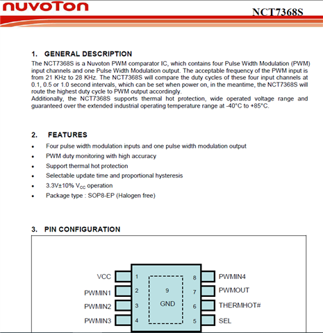

Pls help to suggest P2P P/N VS NCT7368S,tks

Thanks for your interest in our comparators.
Unfortunately I was unable to find the datasheet for this device. From the short description you shared, I do not believe that we can replace the function of this device with a simple comparator. If you can attach the datasheet, I can review further.
