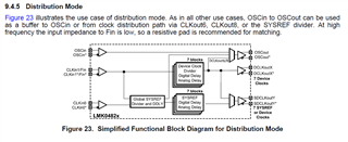

Is it possible to output 1.2GHz LVDS clock with 1.2GHz LVDS clock input in distribution mode?(See 9.4.5 on page 55 of the datasheet)
At this time, does SYSREF also output?
Can I do the above actions if I input only the CLKin/Fin,CLKin1*/Fin* pin?
Do I have to input both the CLKin/Fin,CLKin1*/Fin* pin and the CLKin0,CLKin0* for the above operation?
  • Hi Kim,
    Yes, LMK04828 can operate in distribution mode and will produce same output frequency as input after setting DCLKoutX_MUX in bypass mode.
    It will produce the SYSREF output frequency based on SYSREF divider value.
    CLKin1, CLKin1* input only sufficient to distribute DCLK and SYSREF outputs.
    CLKin0 input can only distribute at SYSREF and/or OSCout pins.
