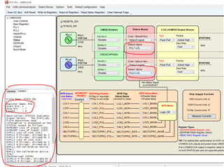

    Can you check if the PLL is locked first? You can do so by measuring the STAT0/1 pin status after configuring it in the status page of Ticspro. LOL means Loss of Lock. You can also find register details when hovering the mouse over a register field.
    If PLL is not locked, toggle RESETN_SW to do a soft reset and reinitiate the VCO calibration.
