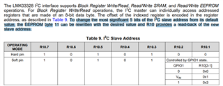

Hi
I am using a USB2ANY in order to program my PLL.
I have two PLL's, the sequence is set to HW_SW_CTRL = 0
When I scan the Address, I get 0x7C
And on my second PLL I get 0x4D.
I set the GPIO1 of the two PLL to be different (one PLL GPIO1 is set to GND: Add 0x0 and the second PLL GPIO1 is set to VDD_DIG - Add 0x3).
According to the datasheet, table 9 the I2C address is: 1010_0_GPIO1, hence for:
PLL1 (GPIO is set to Gnd): 1010_000
PLL2 (GPIO is set to VDD_DIG): 1010_011.
In Addition, if I want to program the PLL from a microcontroller (MSP430), do I need to toggle the reset pin?
The intention is that the microcontroller will program the PLL on every power-up sequence.
Omer
  • Hi Omer,
    the most significant bits of the I2C address can be changed and stored into the EEPROM. See this datasheet section:
    It appears that the EEPROM content was written.
    It is not needed to toggle the reset pin. You can instead toggle the RESETN_SW bit.
    regards,
    Julian
